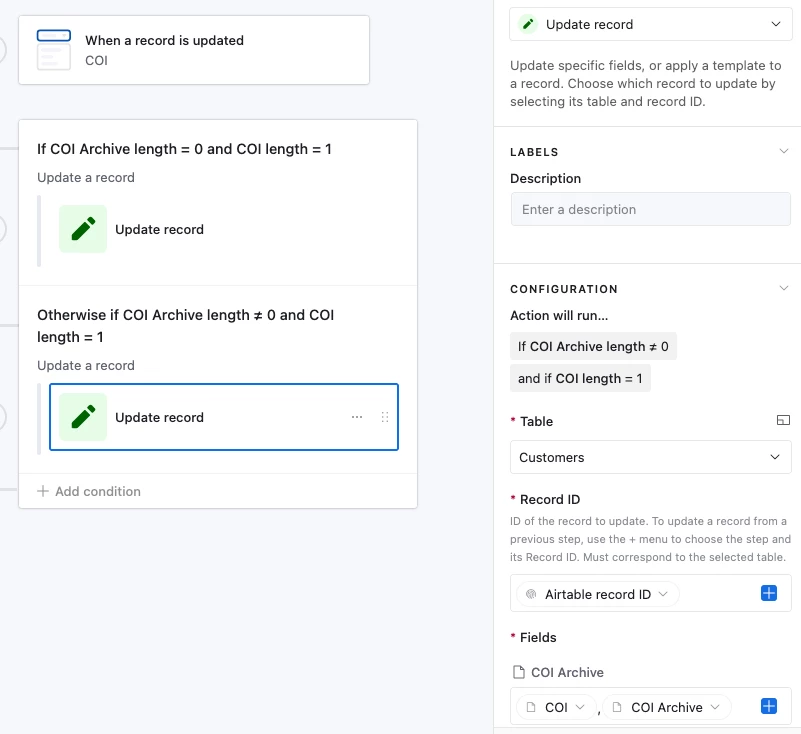

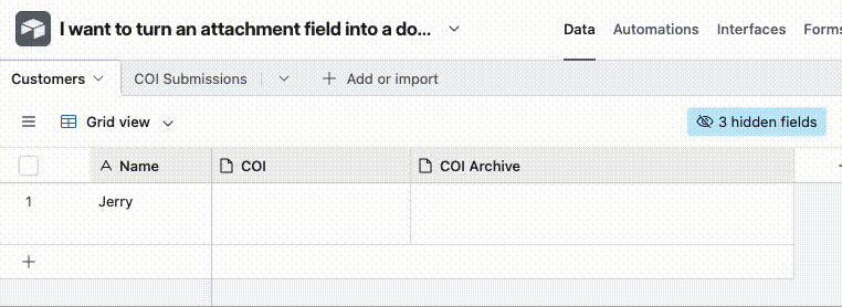

How is the COI being uploaded by the customers?
Some options off the top of my head and set up here for you to check out:

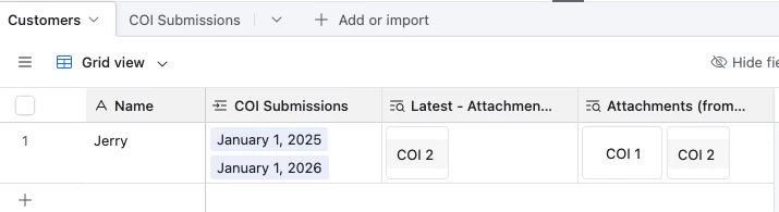

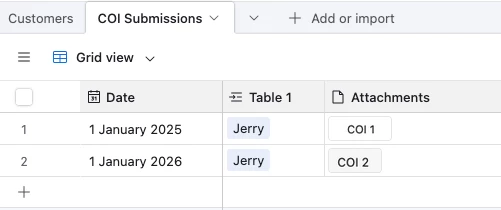

  1. Get users to submit new COIs via form submissions and then do a lookup field
  2. If users are uploading the COI by modifying an existing record, set up an automation that’ll do an archiving process for you like so:
    The idea is to have an automation that’ll check whether the COI Archive field is empty, and if it is, ignore it.  If not, add the new COI into it with the old data:
  3. Same workflow as above, but with the Attachment field set to ‘Versions’ instead of ‘Files’
