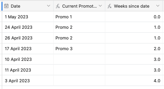

Hi! Thank you for replying.
So, every new person (and date) that is added in Airtable is basically a customer who availed our products. The idea is that they have 1 week to avail our promo 1, and 2 weeks to avail our promo 2 and 3 weeks for promo 3 and lastly 4 weeks/1 month for our promo 4.
So, for example (from the pic) as soon as John Doe and the date he availed our product is added, he has a 7days/1 week to avail our promo 1 which makes "Current Promo" field as Promo 1. After a week, the field would now be as Promo 2 and after that week its Promo 3 and so on.
So far I've only made:
DATEADD(Date, 1, 'week')
to show when the promo ends but that's not exactly what I'm hoping to achieve exactly as I'm trying to see what Current Promo John is on without having to check calendars and dates to confirm the duration of said promo. I know my request may seem difficult and I apologize for requiring a very specific solution.
Ahh I see, is this sort of what you're looking for?
If so, here's a link to the base
And the script used is:
SWITCH( DATETIME_DIFF( TODAY(), Date, 'weeks' ), 0, 'Promo 1', 1, 'Promo 2', 2, 'Promo 3' )
The idea is to find out how many weeks it's been since the "Date" value, and based on that we'll know which promo they're on, does that make sense?

Hi there Adam!
I can't believe it....it really works! Thank you so much, I appreciate it. I can't believe it looks so simple on your end and I was lost for days trying out all kinds of nested ifs/switch formulas.
No matter, I've deleted all my imperfect formulas for yours and it looks so much cleaner now. Thank you once again for your help and I apologize if my problem may have been confusing. Now I know I am not built for coding hahaha.
