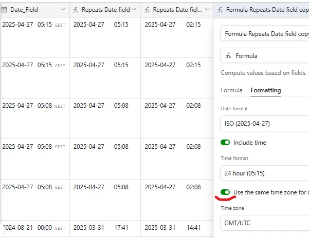

In the "Date and Time" field, when I perform automations on it, it treats it as if it were GMT/UTC even though I defined my own time zone.

Hello.
My time zone is Israel.
I defined the time zone of Israel in the Date and Time field. But when I run formulas or automation on it, it refers to the registered time, as if it were GMT/UTC and this disrupts all my automations.
Is there a solution for this?
Best answer by Alexey_Gusev
In formulas, it depends on that switch, when you enter Formatting.
About Automations - more details needed, how do you trigger them? Usually I’m not targeting time field directly, I found more convenient to make a kind of formula displaying like “X minutes to GO” or “Started” when the counter value (measured by DATETIME_DIFF() ) is <=0. And trigger “When the record matches conditions” (field value is “Started”)
