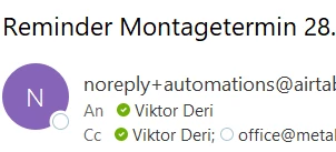

We have noticed the following error when sending automated emails:
Although I have defined the customer as the recipient (with myself as the trigger in CC), the email is primarily sent to me and only to the customer in CC.
Screenshots are attached. Do you have any idea what could be causing this?

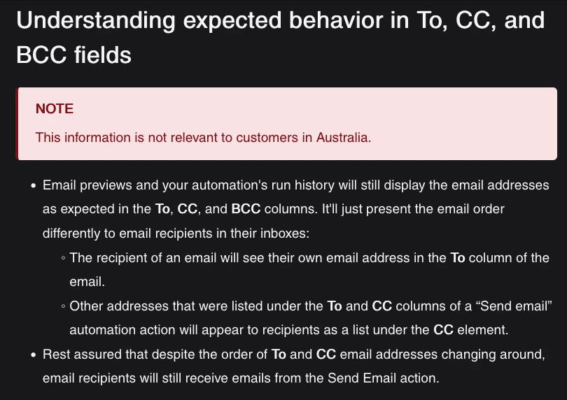

Ah yeah that’s just visual, on your client’s side they see themselves as the main ‘To’ recipient, and you as the CC.  The docs mention this:
https://support.airtable.com/docs/send-an-email-action#understanding-expected-behavior-in-to-cc-and-bcc-fields
