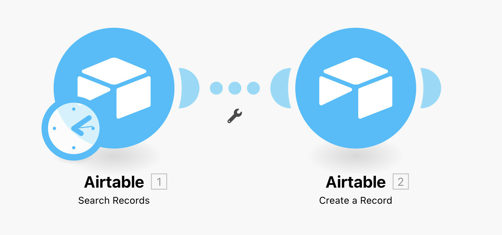

In the meantime, if you’re looking for a no-code way of doing this, I’ve setup two of my Airtable consulting clients with this exact same thing by using Make.com.
I set it up very easily by using these 2 simple steps, and this repeats once a month:

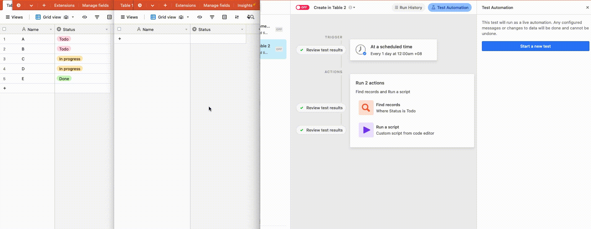

Hey @corb, here’s a base that does what you’re looking for with a script
Trigger is a scheduled time trigger, runs a Find Records action to look for the records, and then creates the found records in the table you set in the script
