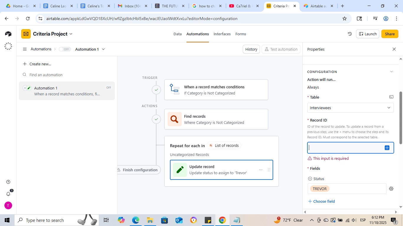

I’d like to configure my Airtable so that when the category for a record is labeled ‘Uncategorized’ it automatically triggers a certain ‘Status’ label.
I’ve been following this tutorial: https://support.airtable.com/docs/repeating-groups-of-automation-actions
But I get stuck when I reach the last step for the action as I’m not sure what to put in ‘record ID.’ Every time I run it, it updates the same record, but I want it to search for all records that have been labeled ‘Uncategorized’ and update their status. How do I do this?

You’re going to want to select ‘Current Item’ and then ‘Airtable record ID’.  This’ll make the automation go through the list of found records and update each of them in turn:

Hey Adam, thanks for this! However, I tried it and it always updates the same record but doesn’t update the rest. See below:
I’m imagining the issue lies in the specific record ID below ‘Airtable Record ID,’ am I wrong? How do I stop it from just updating Margie Curry every time? Thanks!

​@TheTimeSavingCo Never mind, I figured it out and your solution worked! Thank you!
