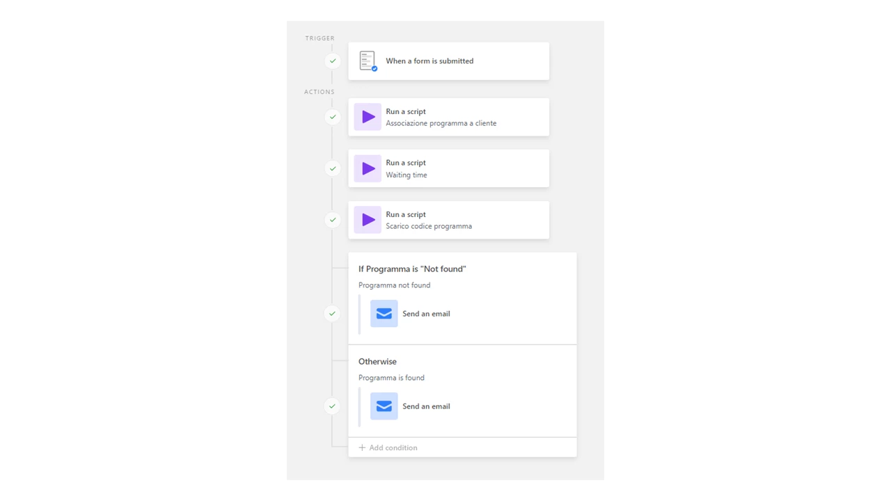

Hello,
in a automation on Airtable I set up a trigger that, when someone submit a form and create a record in a table named "customer", Airtable run a script that have a vlookup function that read a "Program code" value and insert the "Program Name" from "Code" table. If the vlookup have a correspondence than the value of the cell is equal to the "Program Name" if not the cells value is "Not found".
After this action I set up a script that wait 20 sec. in order to wait the update of the data in the record and then I put a condition that:
If the "Program Name" is "Not found" then send an email "Code not found"
Otherwise (and then it means that "Program Name" have the name of the program) then send another email with the landing page and other info.
If I test manually this automation with the function "Test Automation" with a selected record  this action work correctly. But if I submit a form and this automation run with his trigger, the output is always the otherwise condition output.
How it is possible? I see that before the condition start, the field on the inserted record is ready and it is "Not found". How it is possible that the automation not read "Not found"?
Find attacched the structure of the automation. Many thanks!

Hmm, I take it you're updating the record via one of the scripts there, and then your condition uses that updated data?
If so, that's because the conditional is checking on the record's data when the automation triggered, and not the current data.  You'll need to use a "Find Record" step to look for the record you updated, and then use that "Find Record" action's result in your conditional.  I think I would just use `output.set()` if I were you though, seems simpler

Ah, yeah, if you don't have much coding experience let's just focus on the "Find Record" solution!
To do that, try this:
1. In your mainTable, add a new field with the formula "record_id()" and call it Record ID
2. In your automation, add a "Find Record" action right before the conditional, and its going to look for a record in mainTable that has the same Record ID as the triggering record
3. Update your conditional to check the value of the "Programma" field from the "Find Record" action
If you can DM me an invite to your base I can help you set it up real quick!

Hi Adam,
thank you so much for your solution! It work very well!
I used the Find record action that track and update the record and use it for the condition in the automation! Thank You!!
