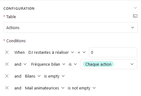

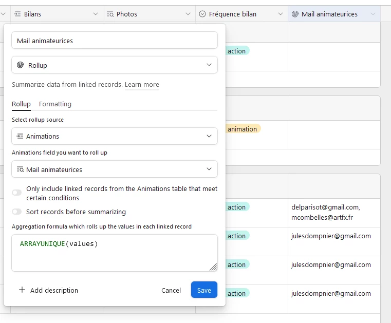

I've made some pretty basic automation, when a record matches certain conditions, I trigger the action "send mail" (airtable default one). The field "To" is filled with a roundup type of field which has a formula "ARRAYUNIQUE(values)". It keeps the unique mails attached to the record.
My issue is that it works 30% of the time. The failure to run is always caused by : "The "To" input is empty"
Which is not, the field is never empty, it always has one or several mails. And it being not empty is a condition to trigger.
I can't find what's common to success or common to failure.
Any ideas ? 🙂
Thanks for trying, here is mine :
Roundup field in data :

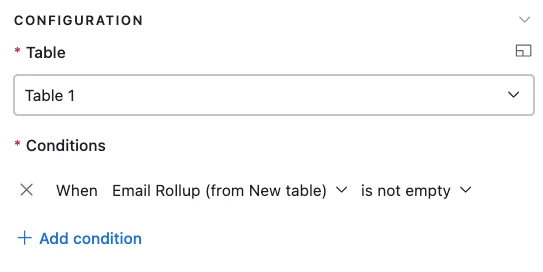

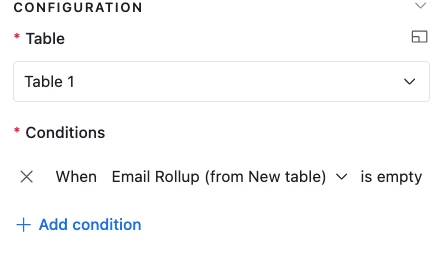

Actually your trigger should be roundupfield is not empty, but it's strange it doesn't show projet 2 and project 3 no ?
Here is the mail configuration with the "to" :

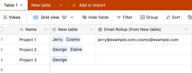

Ah you're right, so sorry about that!  I think I may have figured it out, does this look right?
And to do that I changed the rollup formula to be:
ARRAYJOIN(ARRAYUNIQUE(values))

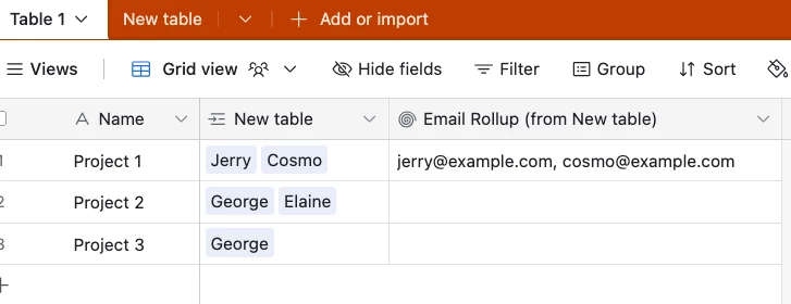

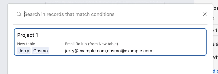

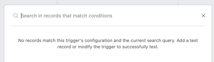

Hmm, I tried replicating that here:
And when testing the automation trigger nothing was available for selection
Link to base
I figure my setup must be different from yours somehow.  Could you take a look and let me know what I need to change to match yours?
Link to base
