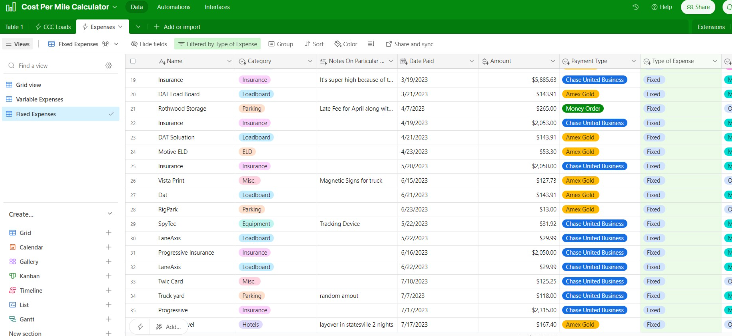

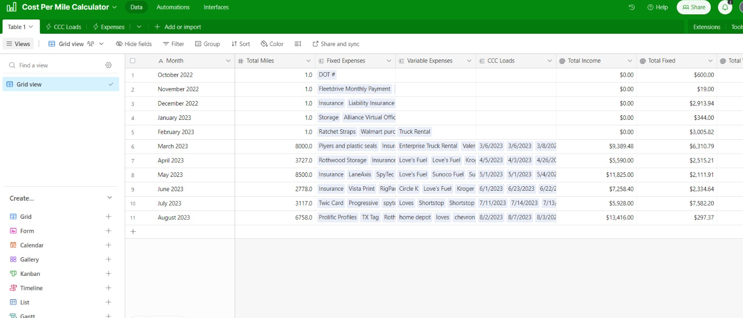

Hello community I am having issues with a table of mine. I run a trucking company and have a table to calculate my estimated expenses down to a per mile bases. So I assign expenses and revenue to certain cells and it help generate my CPM. Although I am have an issue that is making things more time consuming. When I assign and revenue or expense to a cell it does not remove the item from the selected field of available expenses or revenue. Any suggestions on how to solve this issue?

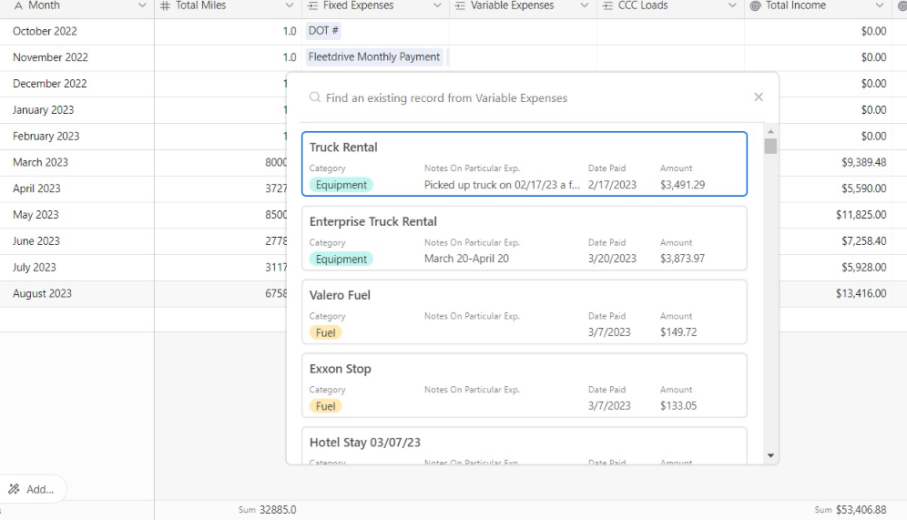

So essentially as I assigned a particular expense or load to cell it is not eliminated from the field and can be assigned to multiple months.

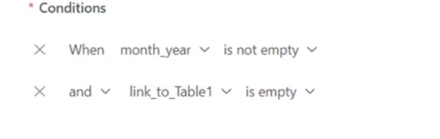

I think you should automate it. In the Table with expenses, add formula
DATETIME_FORMAT({Your Date Field Name},'MMMM YYYY')
Here you can find a doc for possible date formats,
if you want another text representation of the date
I suppose your Date field is Date Paid.
Improve the formula to avoid "ERROR!" if the date is empty.
IF({Date Paid}, DATETIME_FORMAT({Date Paid},'MMMM YYYY'))
And then add automation that will auto-link each new record appear in Expenses.
It should work for records where a formula field you added is not empty, but the link to expenses is empty
It should just copy a formula output to the link field.
Note it will auto-create new record in Table1 when the record with new 'month year' appears, for example September 2023.
I hope that will help you.

Where are you getting this link to table selection? Or what are you referring to.
Alexey_Gusev
Forum|alt.badge.img+25
  • September 3, 2023
sorry for late answer.

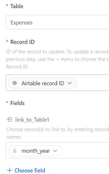

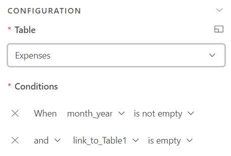

It's automation, where you should choose trigger.
Some triggers might work almost in the same moment, for example "When form submitted" and "new record created" (because form submission results in a new record). But when you created it by hand, no form submissions happened. Worse, trigger "when record created" clicks on the new record with empty values, so  you cannot this trigger used in rare cases.
So, in your case use one of the most used triggers - "When record matches condition". The logic is simple - when some record has date entered in {Date Paid}, but not linked to the date in "Table 1", formula will format this date like "September 2023" and trigger will run action.
In Action, you put "Update record", select table, field, and then value to put into, which you should select from input trigger data and all previous steps.
