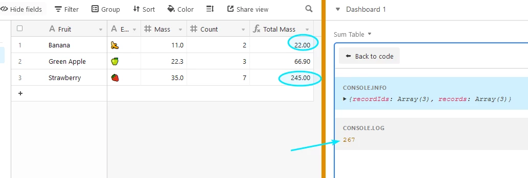

This mornings coffee break, I created this example using a Scripting Extension - once you have an understanding of this, we can then talk about how to gear it within an Automation Script (which will be a very similar exercise, with minor differences).
The key to this is using the Javascript reduce() method. I've also demonstrated how you can filter the data using a filter() method, before the data is summed via reduce().
const emailTable = base.getTable("Numbers Table"); let records = await emailTable.selectRecordsAsync({ fields: ["Fruit", "Total Mass"] }); console.info(records); let initialValue = 0; let sumMass = records.records .filter( (record) => record.name !== "Green Apple" ) .reduce((accumulator, record) => record.getCellValue("Total Mass") + accumulator, initialValue); console.log(sumMass);
Here, we can see the data that's been filtered, then reduced - and the final total;
