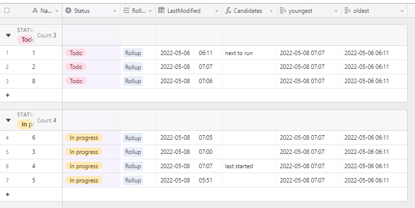

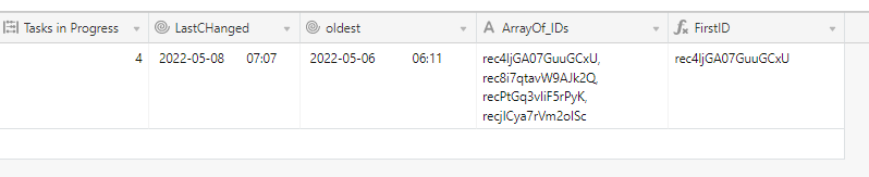

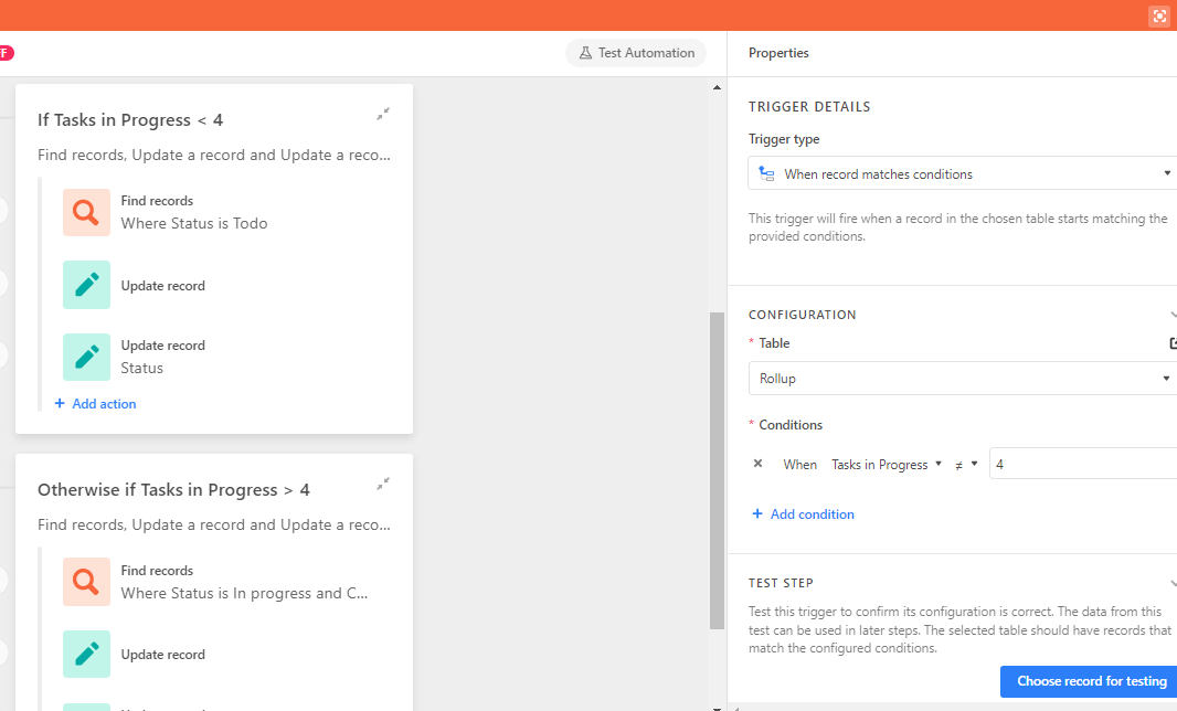

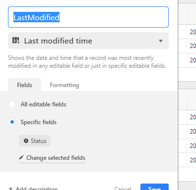

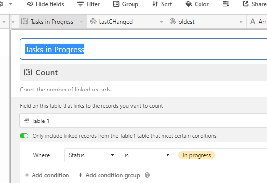

Funny puzzle, I created 2-way automation - to hold number of In progress = 4, no more no less, and learned how to extract single ID from ‘Find records’ results without code, using extra fields in ‘one-record table’. I can’t leave this copy long enough to share, but can explain by images.
