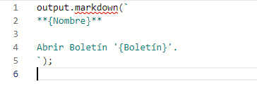

I have been trying to set a an automation that filters records under specific conditions and then opens an URL contained on a field of that record. I have learnt that this is not possible through Airtable, so im also working through Make to achieve it, but its not being easy for me either. But i have seen another  possible solution: Open it through a clickable link in markdown.
So im trying to write a script in other to do so. The input is already set up, but when i try with output, it doesnt work.
This is what i have writen so far:
And this is the error i get:
Could some some help me a little bit?
Thanks.

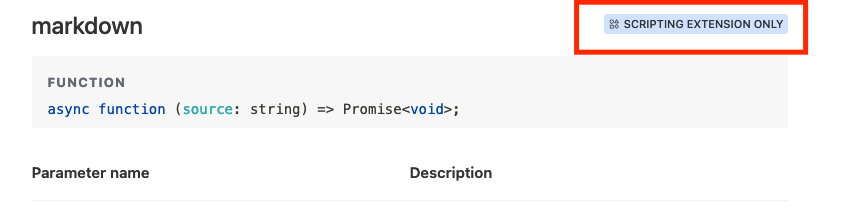

That's only available in the scripting extension; check out the docs here: https://airtable.com/developers/scripting/api/output#markdown
There's a lot going on in your post and I think you might be going down the wrong path?  If you could explain what you're trying to do exactly we might be able to provide advice on how you could try to achieve it, be it through automations or Make etc
