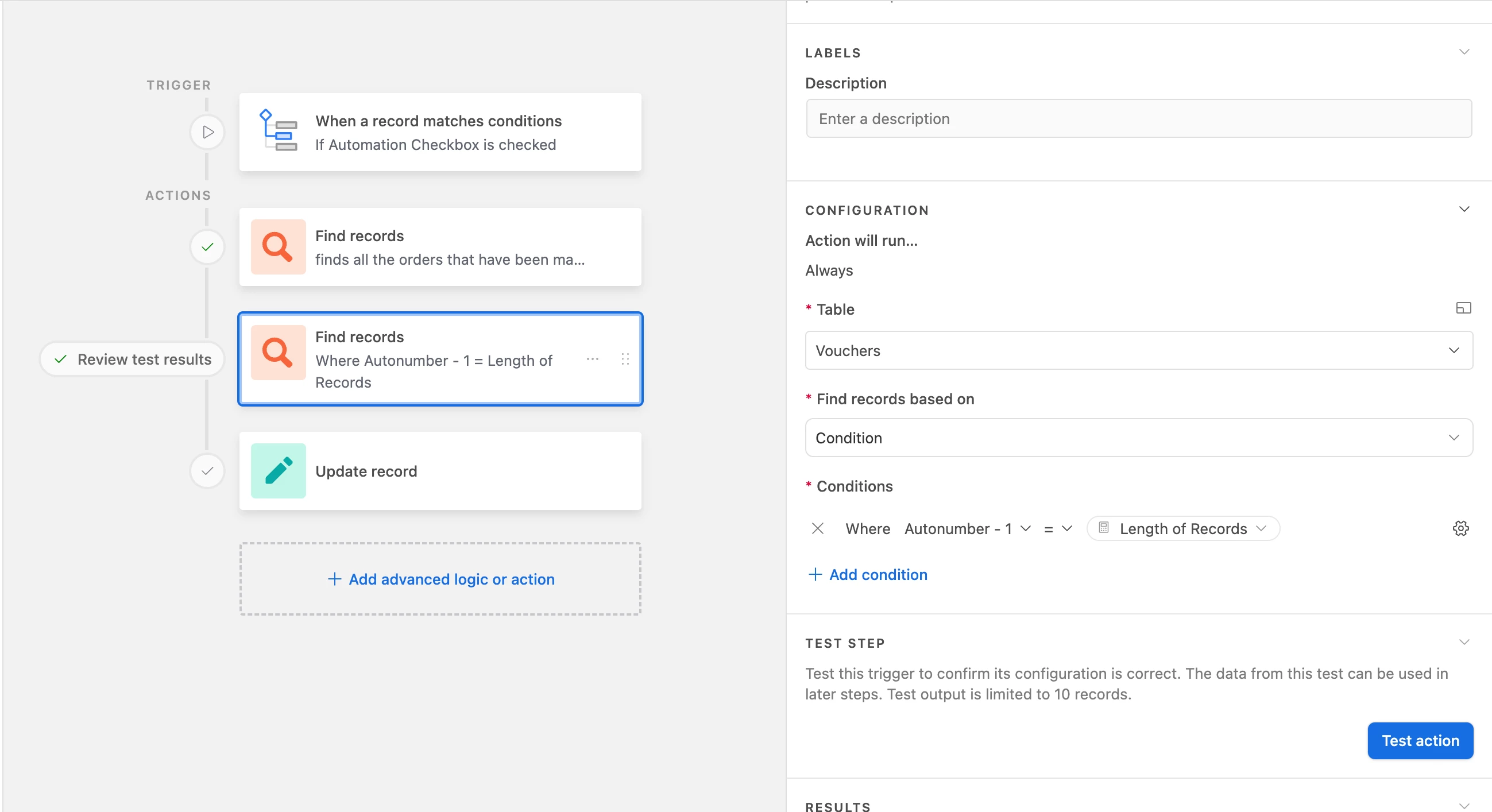

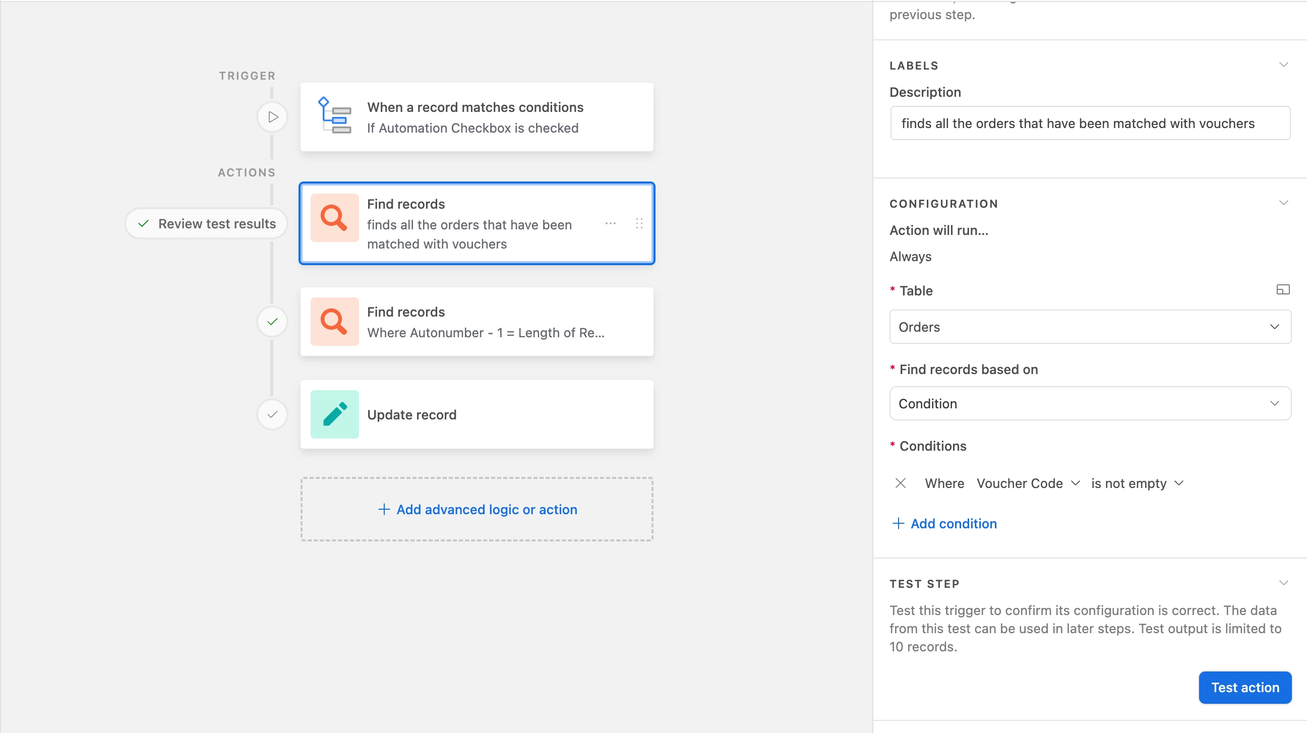

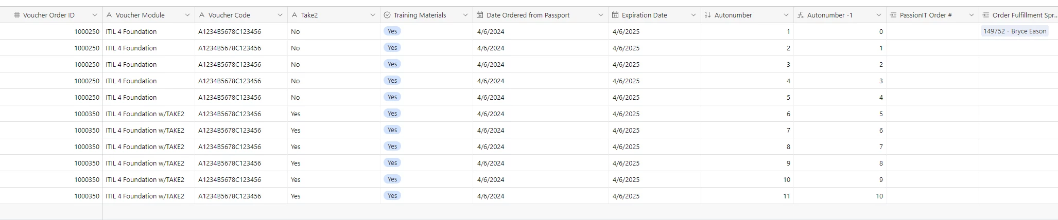

Here's a way to do it, but you need an autonumber assigned to the Voucher records and another formula field to subtract 1 from that autonumber. Basically, the automation triggers when you check the box and then it
FINDS all of the Orders that have already been attached to Vouchers (in a 1-to-1 relationship)
FINDS the Voucher that has the autonumber-1 that matches the number of records that have already been linked to Orders
UPDATES the Voucher record that you just found with the Airtable ID of the Order you clicked the box to trigger the automation for.

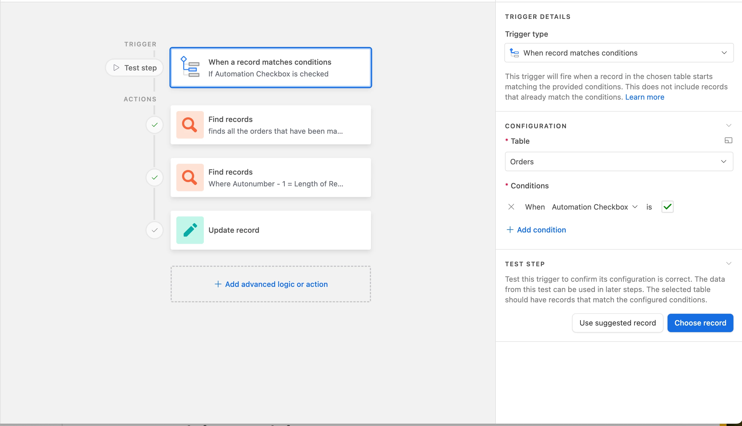

pressGO_design
Oops I changed the settings so that you can copy the base - that will get you the formulas. For the automations, I'm attached a bunch of screenshots that show the parts so you can duplicate them.

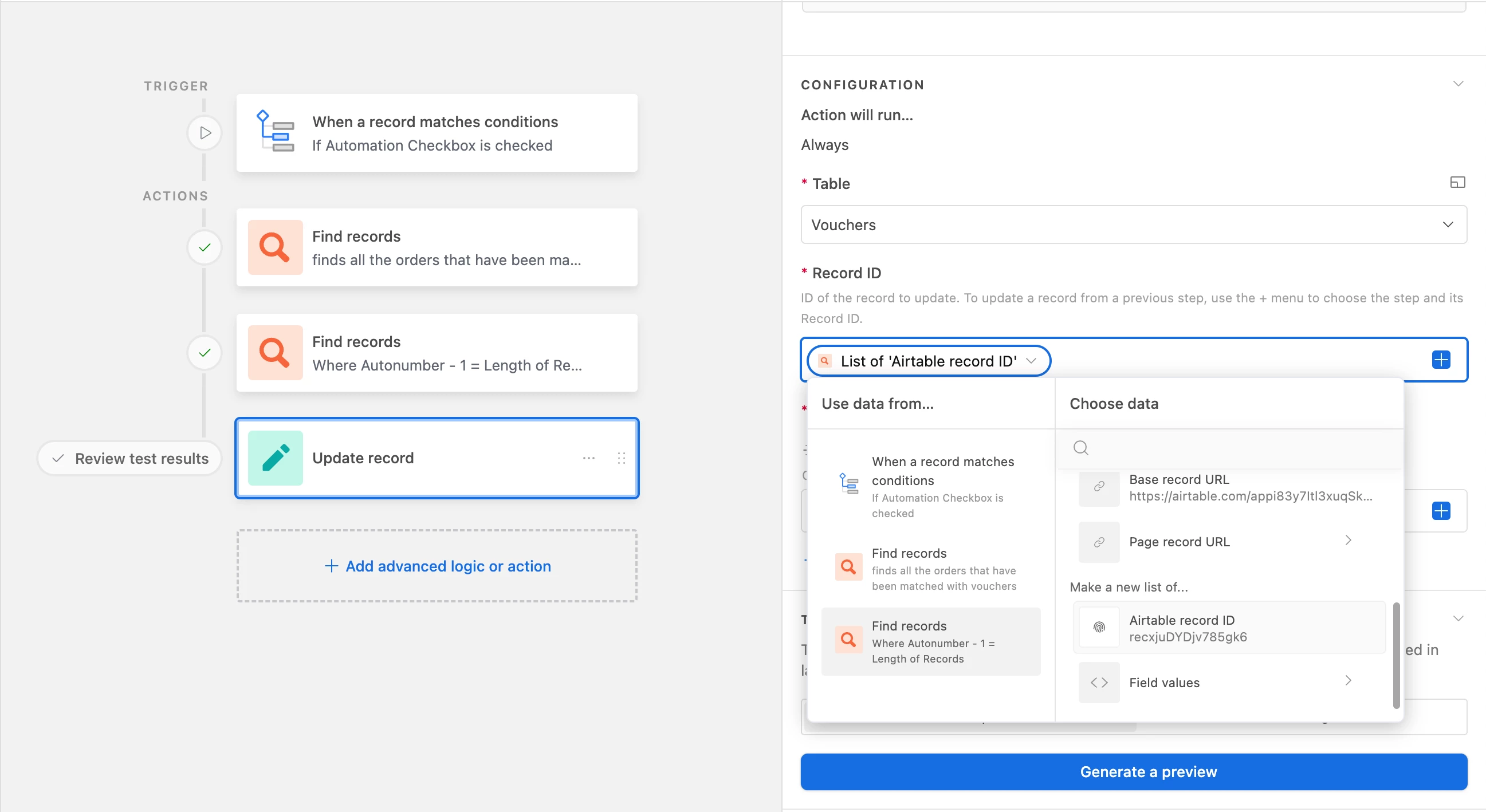

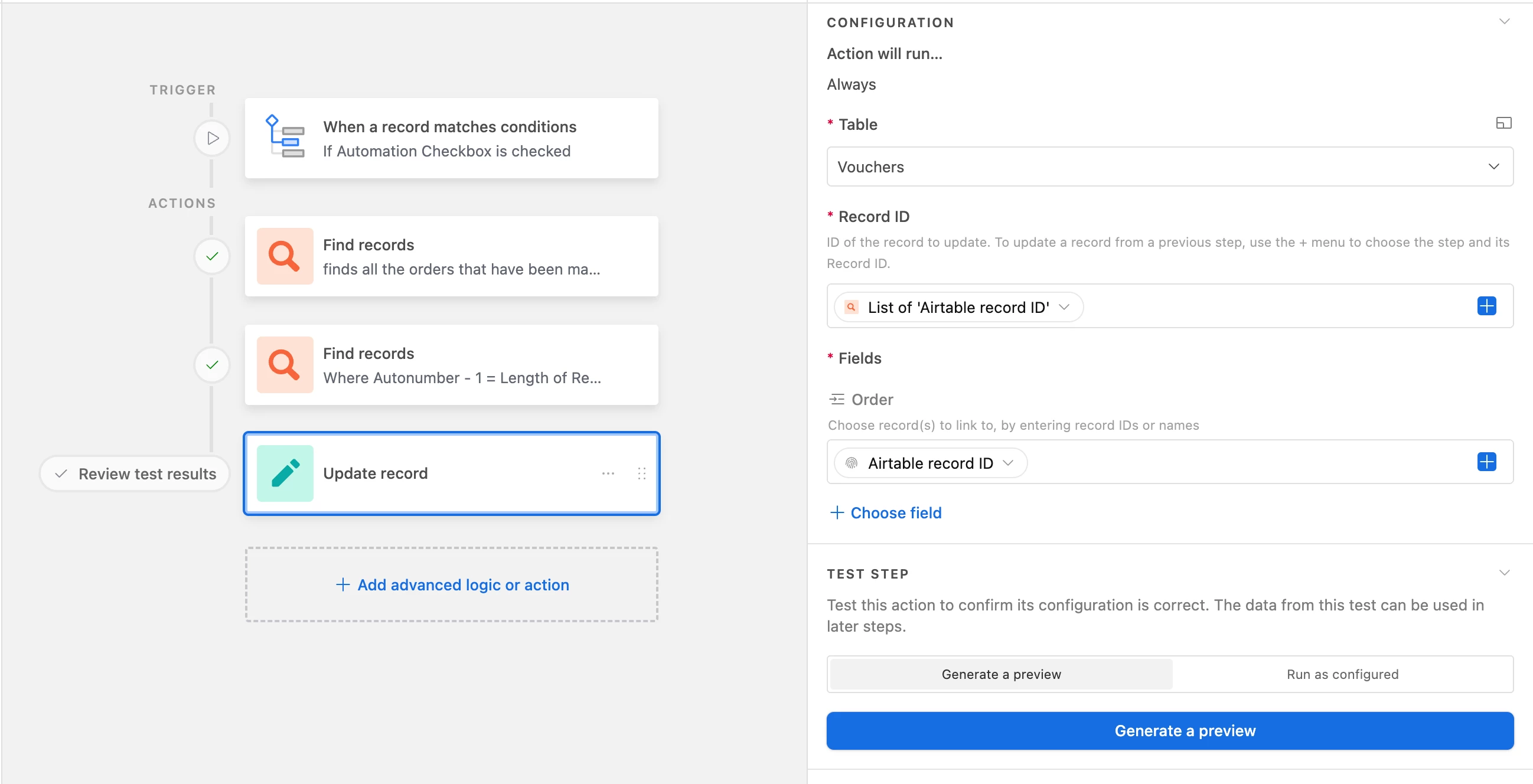

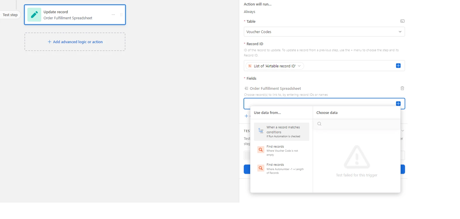

So I copied the automation as you have it and it looks right up until the Update Record step.
The 'List of RecordID', is that from the Find Records of where Voucher Codes is not empty or where Autonumber -1?
And then the final part Order Fulfillment Spreadsheet Airtable Record ID?  Where is that from?  From the where Autonumber-1 find record or something else?
pressGO_design

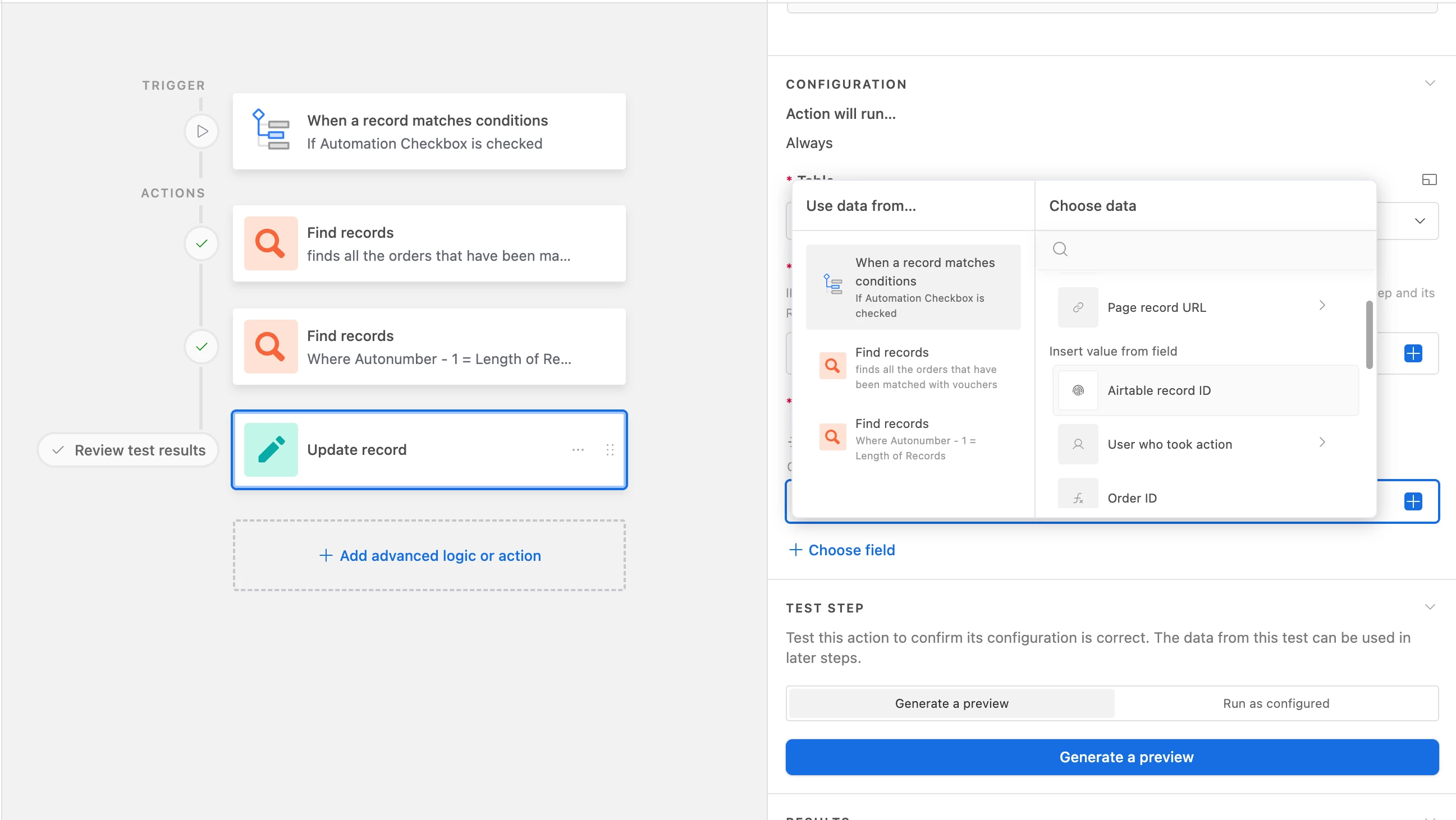

I've attached 2 screenshots that I hope help.
In the Update Record step
  1. The record you're updating is the one you just found in the Vouchers table using the Autonumber-1=length of the Order records that aren't empty. Airtable says this is a list, and in most cases the FIND records is a list, but in your case the number of records that it finds will always be 1.
  2. The field that you're updating is the RecordID of the original record that you clicked the checkbox in.
pressGO_design
In case step 2 wasn’t clear: you’re updating the linked Orders field in the Vouchers table with the RecordID of the record that, when you checked the box, triggered the automation. So if you’re triggering the automation with Order 3, you want the RecordID of Order 3 to go in that linked record field.
  • April 7, 2024

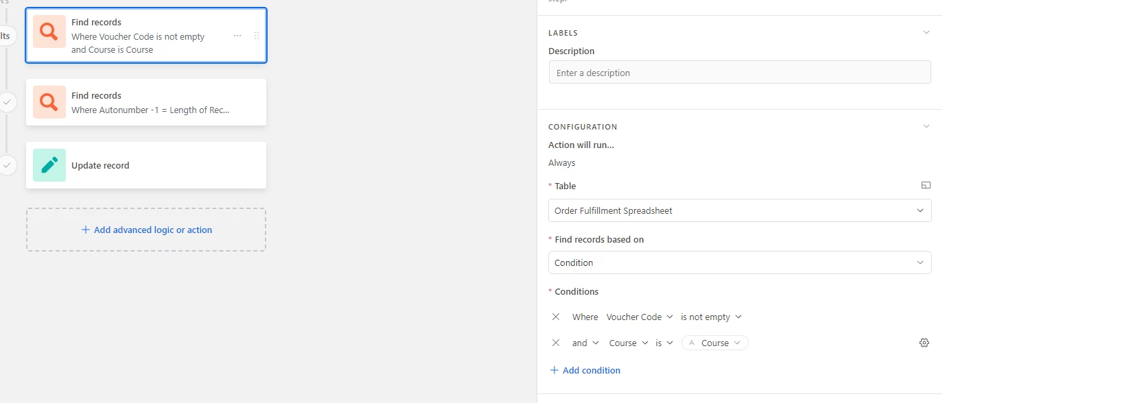

That makes sense and it works.  It chose the next available record.  However, how would I make it choose the next available based on what the Course column says?
And it just adds the link to the record in Voucher code, is there a way to have the actual field value show instead of just a link to the record?
  • April 7, 2024
So I added a condition to the Find records to be AND Course is Course field from Order Fulfillment table.  Is this correct or am I missing something to make it match the course?
