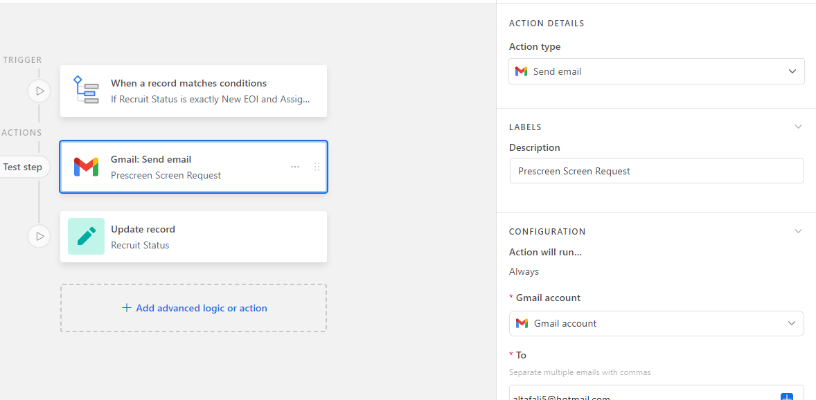

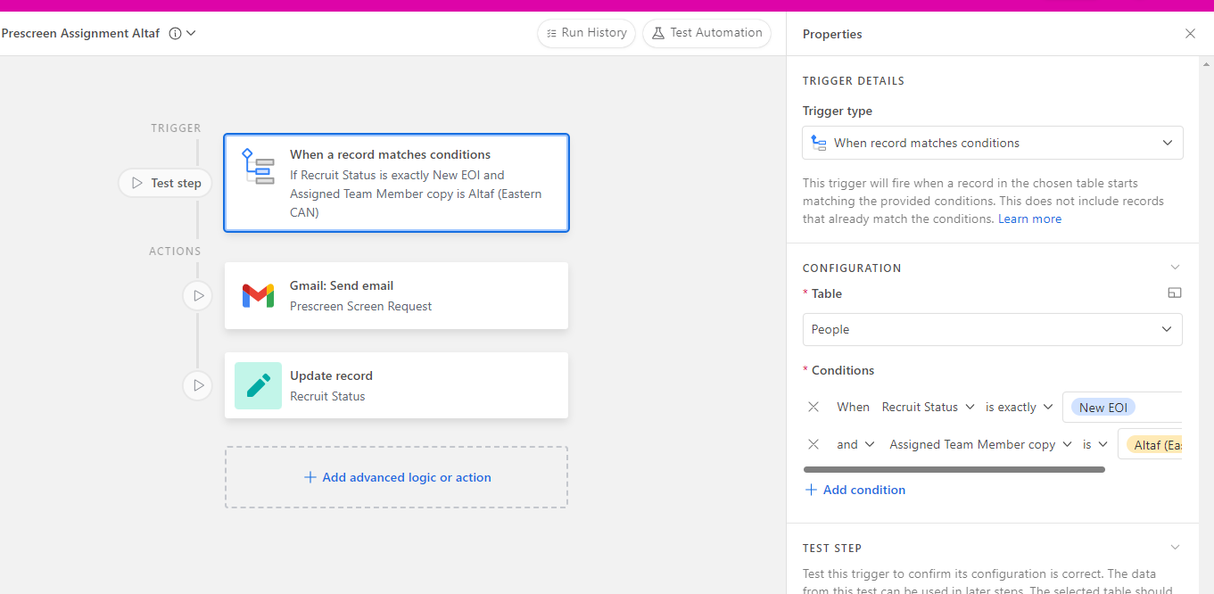

I have created automation when the condition matches  and assigned to person "A" then it should email person "A"
In the same automation, I would like to add another condition whereas if assigned person is "B" then it should email person "B" only. How can I add multiple action in one automation whereas based on each action the email goes to a different person.
Please see attached screenshot.
