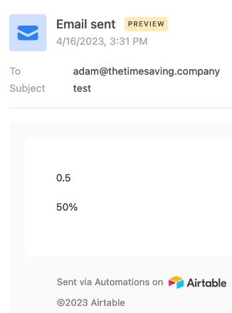

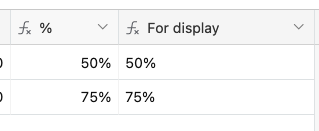

What if you created a formula field to format the value into a display that you wanted like so:
And the formula used was:
{%} * 100 & "%"
