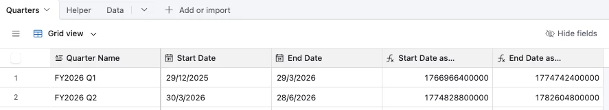

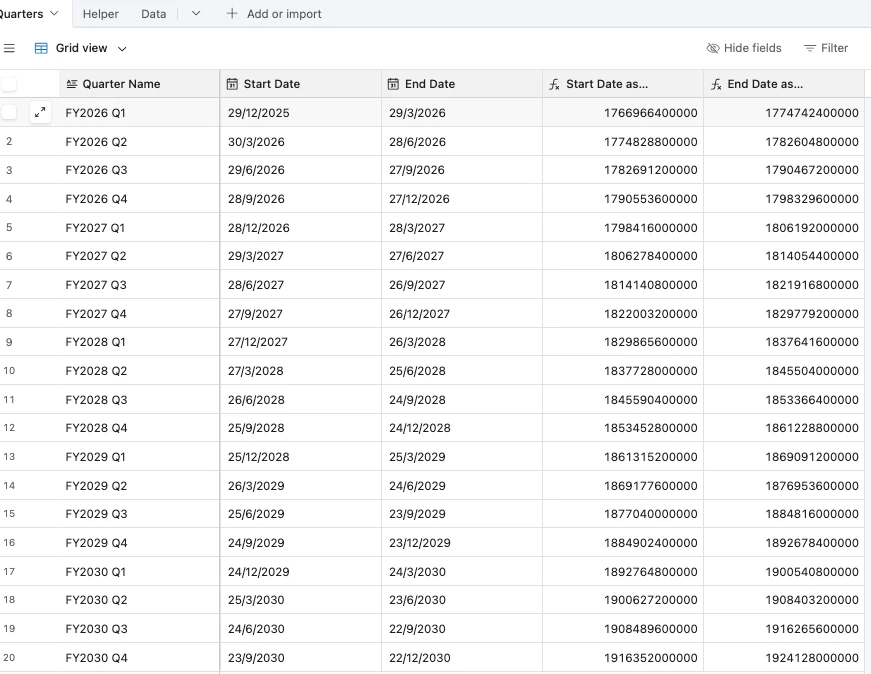

The automation system works with a Quarters table that you’ll need to keep updated, and every time a Date field gets updated an automation will trigger to look in the Quarters table for the appropriate quarter

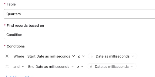

The main tricky bit to this is that Airtable doesn’t let us do Date comparisons in a ‘Find Record’ step, and so to get around that we need to convert our dates into milliseconds:
In order to convert the actual Date value we want to check into milliseconds, we have two options:

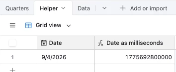

  2. Create a Helper table where the automation dumps the date value and use the formula field from there
    1. The setup above uses this option as I find it slightly neater to set up

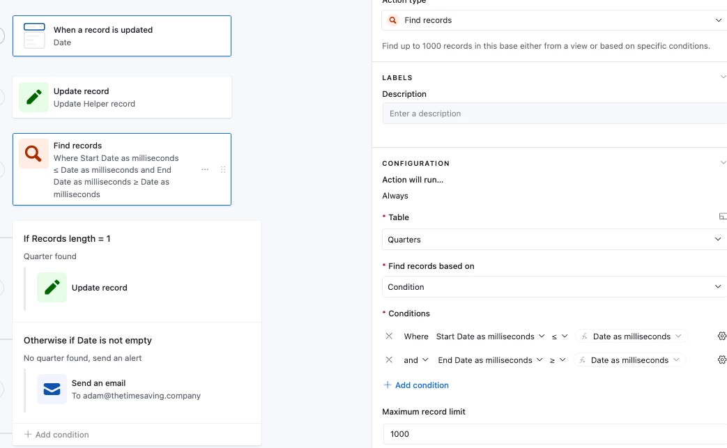

And so the automation does the following:
  1. Pastes the ‘Date’ value into the Helper table’s ‘Date’ field
    1. This allows us to use the date as milliseconds value:
  2. “Find Record” step that looks for the appropriate quarter:

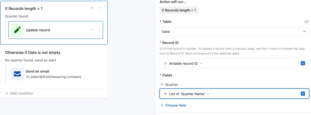

  3. And then an Update Record step to put in the found quarter name, and if it can’t find it, email you an alert

Thanks ​@TheTimeSavingCo - this automation worked perfectly.
