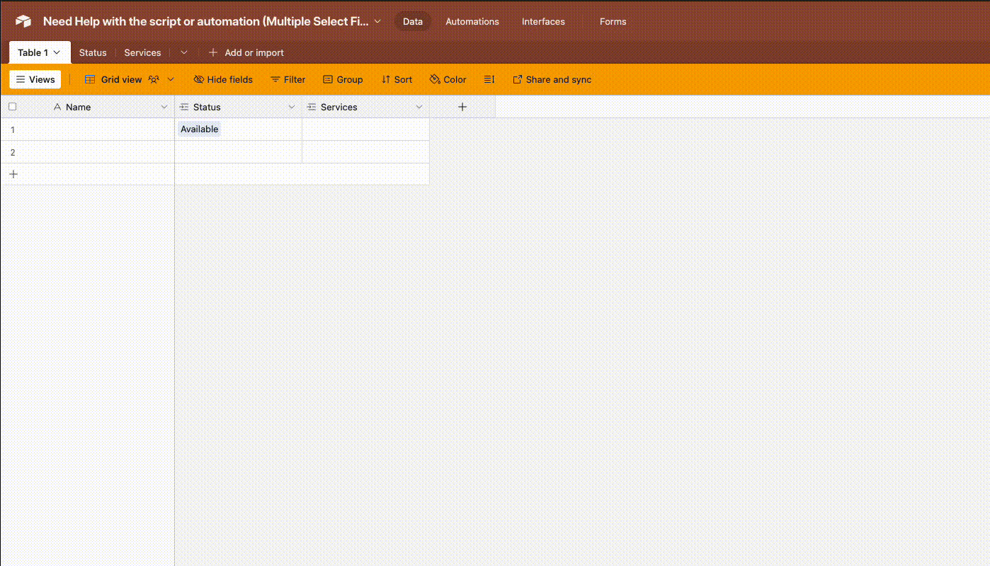

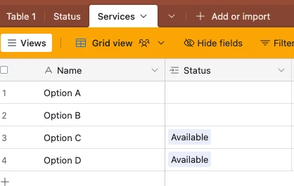

Hmm I don’t think this is possible with a script or automation I’m afraid.  If you have a paid plan you could try a workaround using new tables and linked fields that should do what you need though!
To get this to work you’ll need to link the Services to each Status like so:
If this looks right to you I’ve set it up here for you to check out!
