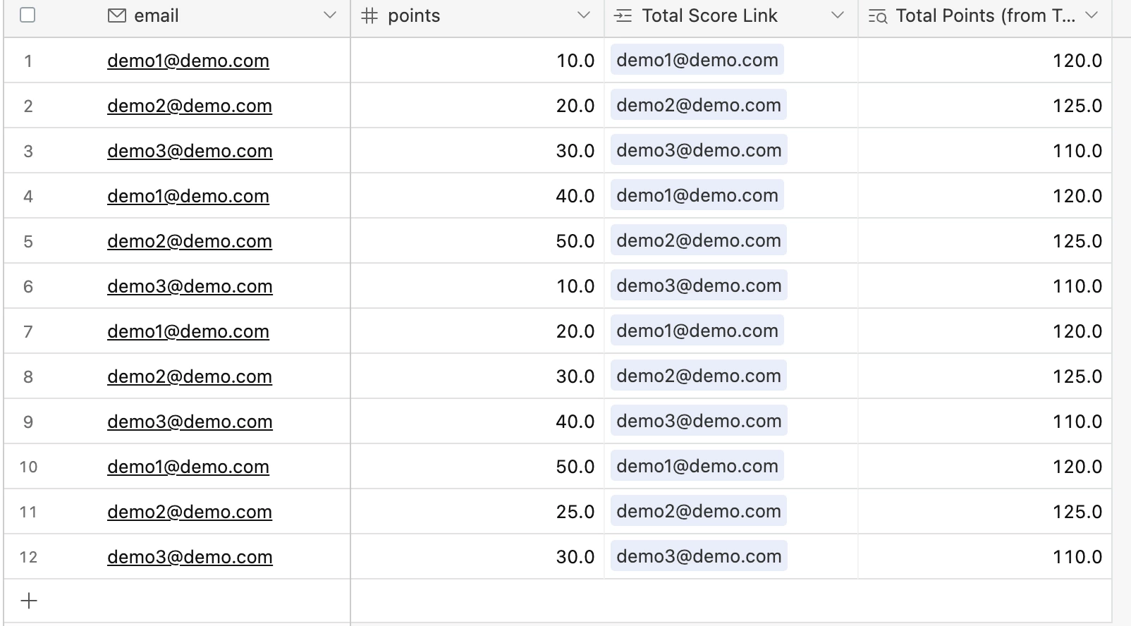

You don't need a script to do this.  The rollup feature already does this for you.  See this sample
I'd recommend reading the documentation: https://airtable.com/developers/scripting/api
A lot of the code you're shared doesn't match existing functionality or syntax, e.g. "update" instead of "updateRecordAsync"
  • April 30, 2024
Thank you for your reply.
I had already tried Rollup.
If you use Rollup, I think you need to manually enter the values of the fields to explicitly put the relationship with the other tables.
I was considering using the Airtable script because I wanted to avoid manual input.
If it is possible to use Rollup automatically, it would be helpful to know how to do this.
  • April 30, 2024
