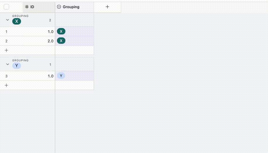

Does this look right?  If so I’ve set it up here for you to check out!
The idea is to have an automation that’ll trigger whenever the grouping field is one of the values you care about, and in the gif above the assumption is that you’re grouping by X, Y, and Z

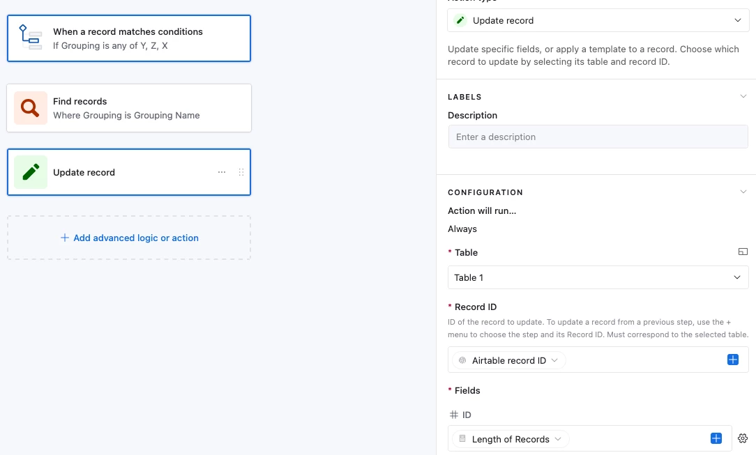

The automation then does a ‘Find record’ step to look for all records with that grouping:
And it then updates the triggering record with the length value of the Find Record step:
Potential edge case is if the user triggers the automations in quick succession which might cause the same ID to be created.  There’s ways around that but probably easier to handle it manually if that’s possible.  Let me know if it has to 100% be right and I’ll see if I can figure something out!
