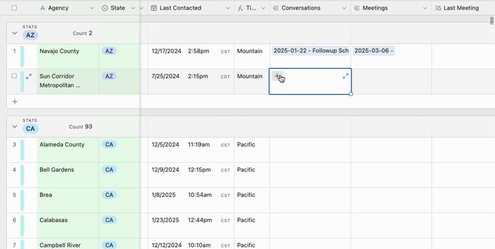

I can't find a script or automation that opens records in expanded view. Right now they have to click the + in the linked record field, then click the + in the drop down menu to create the linked record. It 'works' but there's room for error and I want this to be as simple as possible for them while they're on the phone. This is what that looks like:

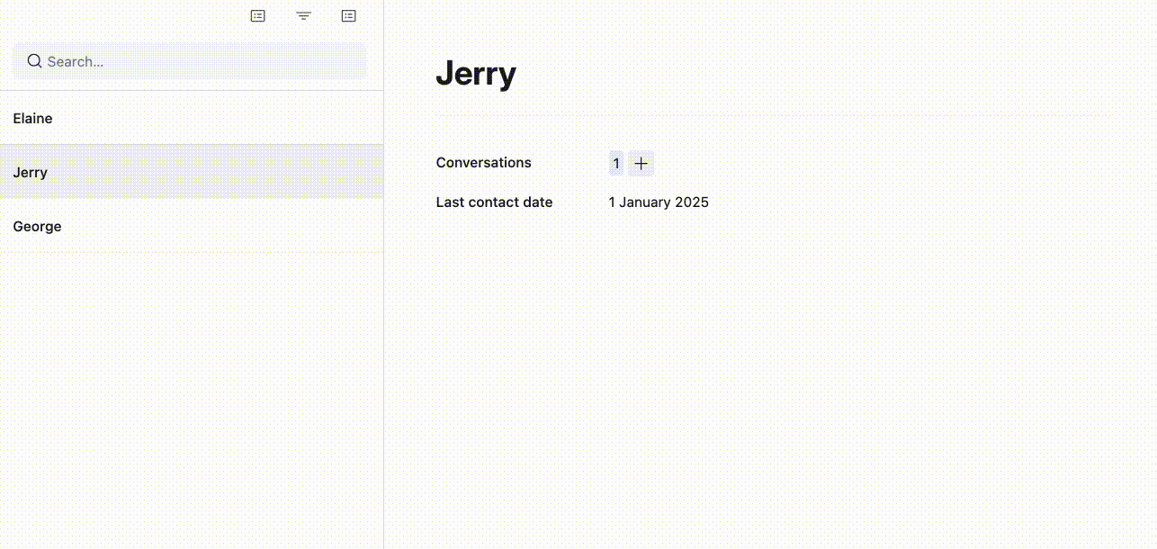

Hmm I don't think that's possible at this time I'm afraid.  What if you gave them an Interface to do that instead?  I tried creating a Record Review interface and when adding linked records it opens the form immediately
Also, instead of using an automation to update the 'Last updated' field, what if you used a rollup on the 'Date' field inside the 'Conversations' table?  By using the formula 'MAX(values)' it'd always output the latest date, does that make sense?
