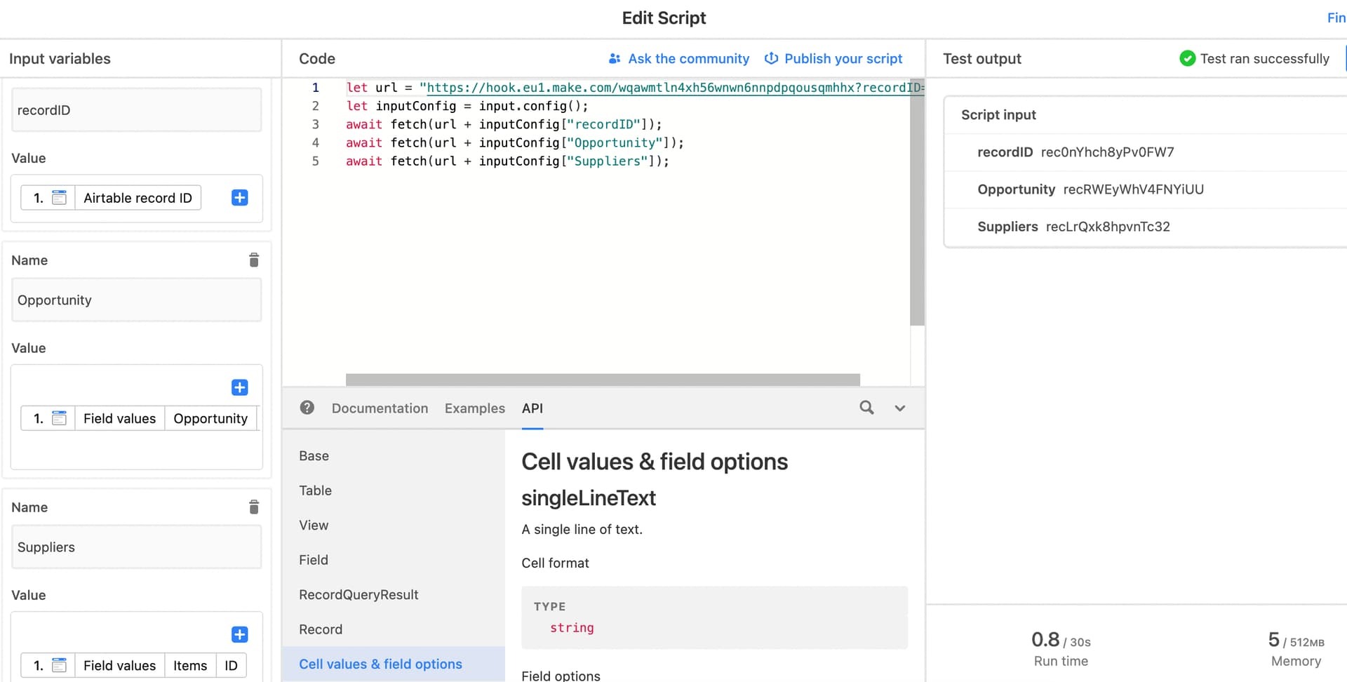

I would appreciate some help. I am using automation to send Airtable records to Integromat webhook and I have successfully managed to send and work with data “recordID”. That is also the trigger in the first step of the automation “When record updated”.
The remaining two Input variables are linked files, and I can not manage to receive data from linked files in Integromat.
Maybee these two lines should me rewriten since they are linked files?
await fetch(url + inputConfig[“Opportunity”]);
await fetch(url + inputConfig[“Suppliers”]);

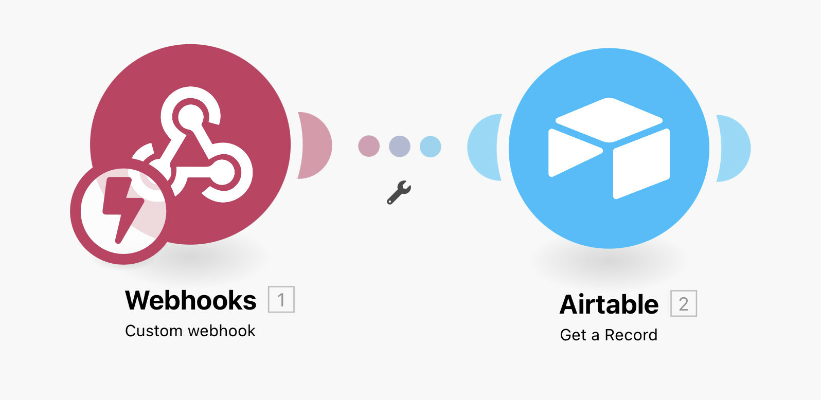

Yes, that is possible.
However, the much easier way is to just send the Record ID to Make.
Then, you would use the Airtable — Get A Record module to pull in all the field values, including the linked record IDs.
Please see screenshot below on how to do this.
Also, I give all the scripts that you will need to use for either of these approaches (your approach or my approach) in this thread:
Instantly triggering a Make automation from Airtable using a webhook.
Also, for those who are new to Make, I’ve assembled a bunch of Make training resources in this thread.
I also give live demonstrations of how to use Make in many of my Airtable podcast appearances here.
p.s. If you have a budget for your project and you’d like to hire an expert Airtable consultant to help you with any of this, please feel free to contact me through my website: Airtable consulting — ScottWorld

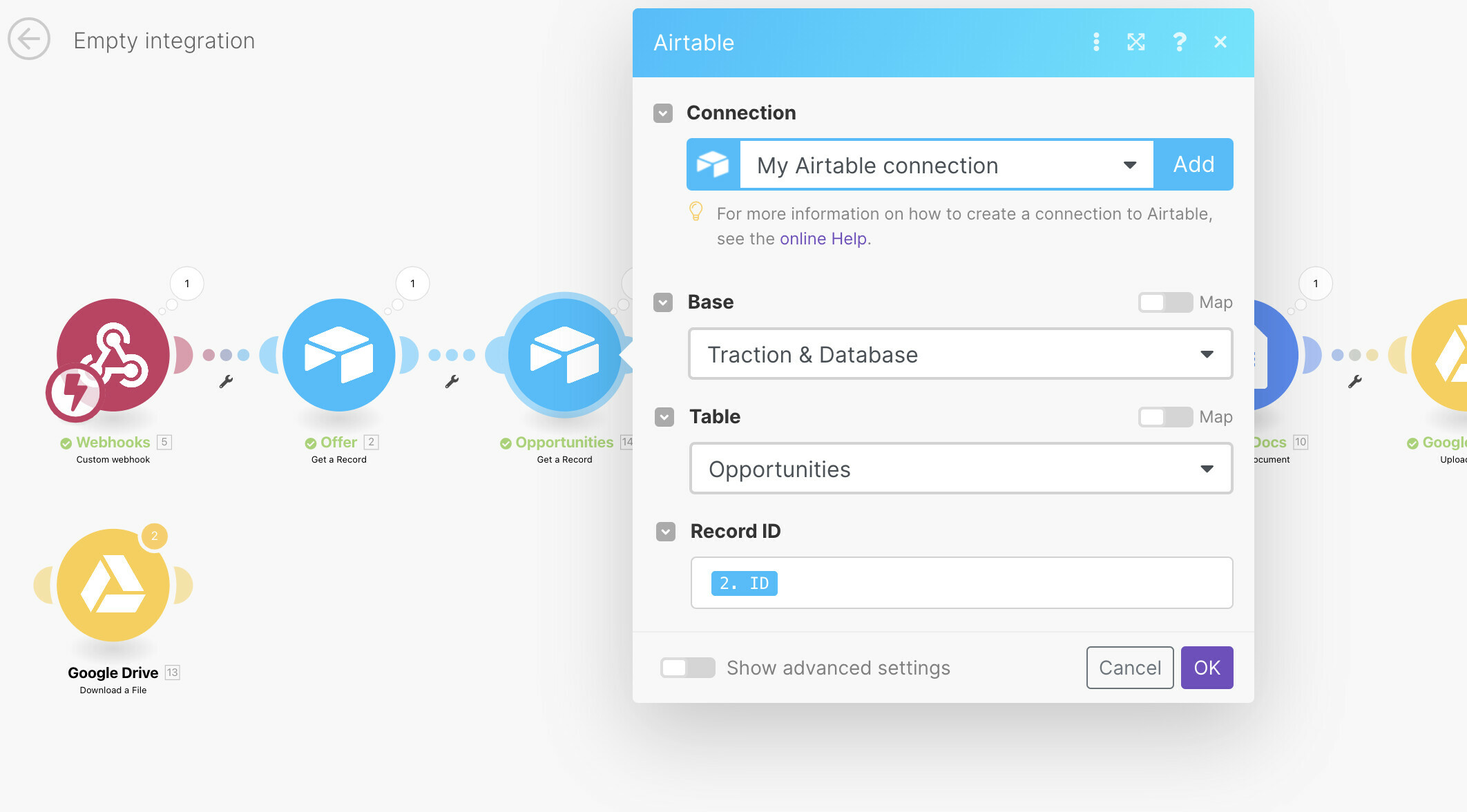

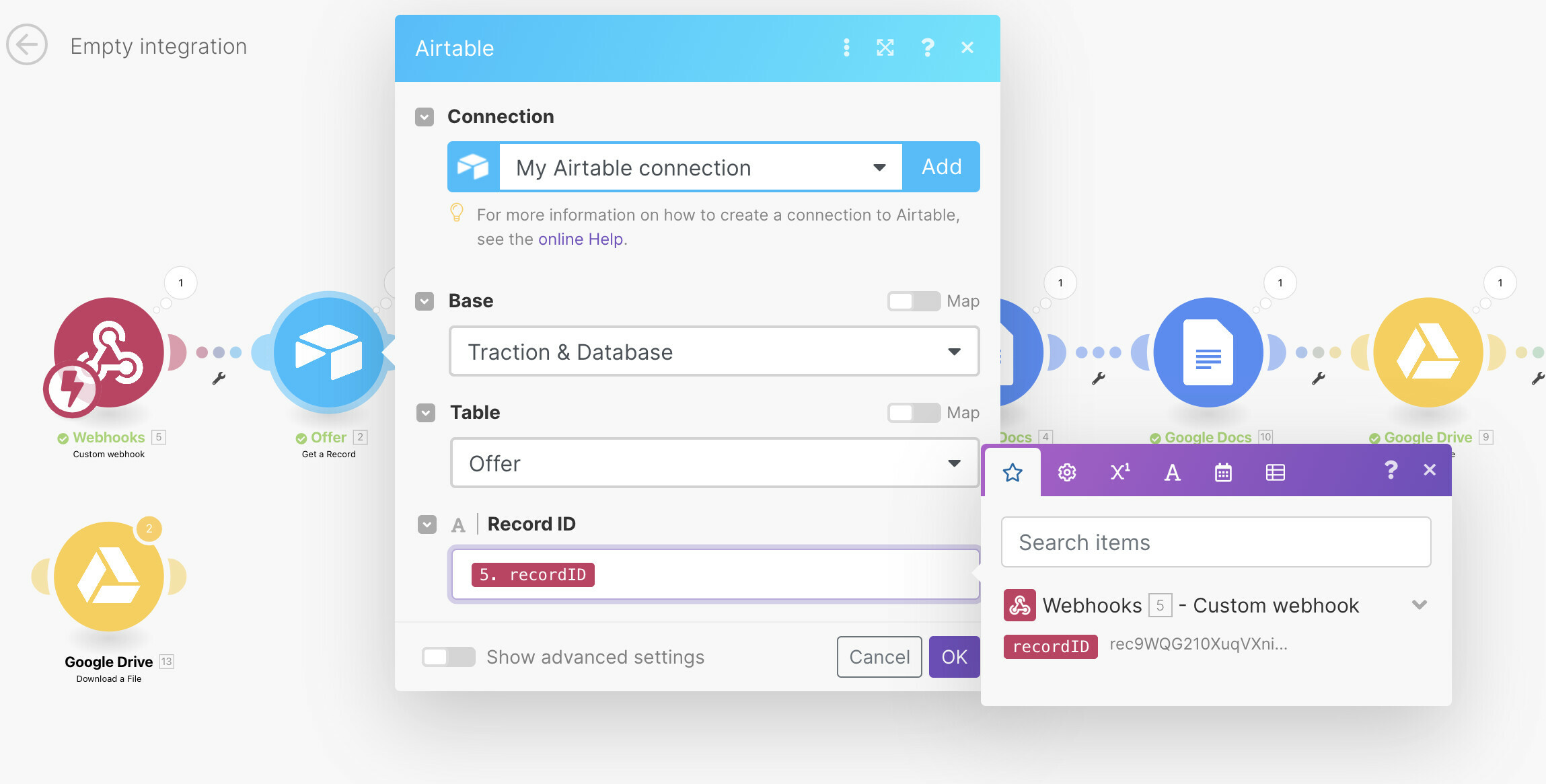

I did that, and I manage to get the fields visible, but it does not pull the values. :man_shrugging:
  • May 25, 2022
I can’t see how you’ve configured those modules.
Forum|alt.badge.img+10
  • May 25, 2022

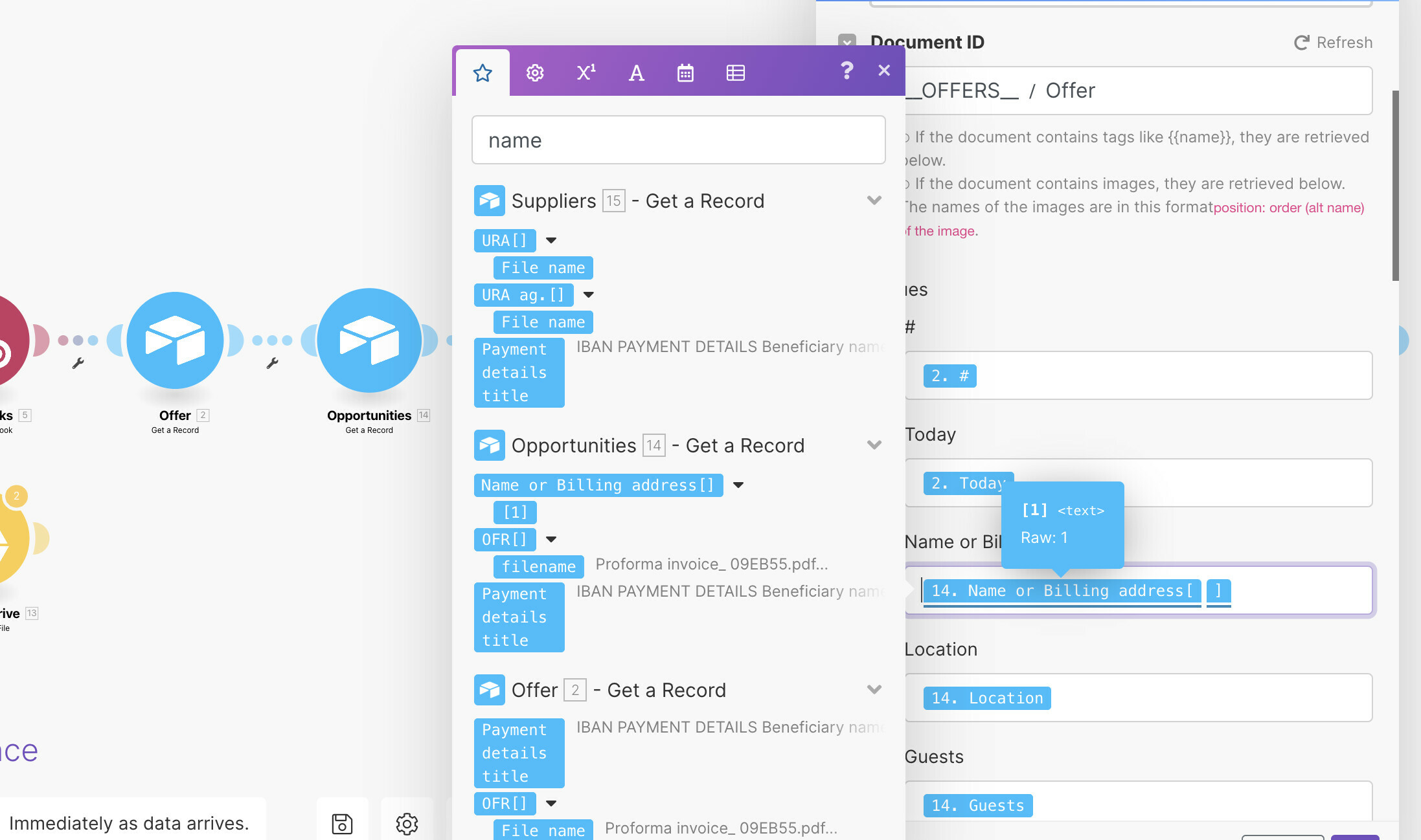

On google docs(document I am creating) I receive only data from “Offers”, Airtable module…
  • May 25, 2022
You’re not using the right ID for your linked records. You have to pull the IDs from the linked record fields.
  • May 25, 2022
Could you share how to point to the right ID?
  • May 25, 2022
In the box where you chose the ID, you can choose different field values from your #2 module. If you don’t see the values, send another record to the webhook — a record that has all the fields filled in.

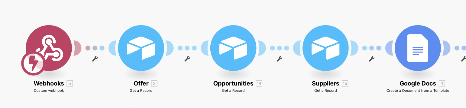

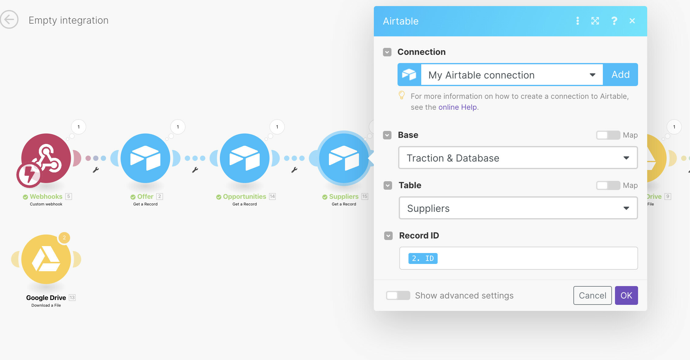

In the third record, I choose the record ID of the linked Opportunity record in that base and I still do no see value from that linked record? Do you have an idea of I might be doing wrong? Please see the screenshots below.
  • May 25, 2022
I figured out that the problem is when I have two records in a linked field… I works fine with one linked field, but two give an error. Is there a solution to that?
  • May 25, 2022
The linked record field returns an array of Record ID’s, and you can’t pass an array to the “Get A Record” module, which is only expecting a single Record ID.
You saw that if your array only contains a single Record ID, it will work because it’s only passing a single Record ID, but if you have an entire array of Record ID’s, it won’t work.
If you want to do it manually, you will have to choose the #1 option underneath the name of the field if you want the 1st linked record, and the #2 option underneath the name of the field if you want the 2nd linked record.
If you want ALL the linked records, regardless of quantity, then you’ll have to use the “Iterator” Module to iterate through the array, so it will send one Record ID at a time to the Get A Record Module.

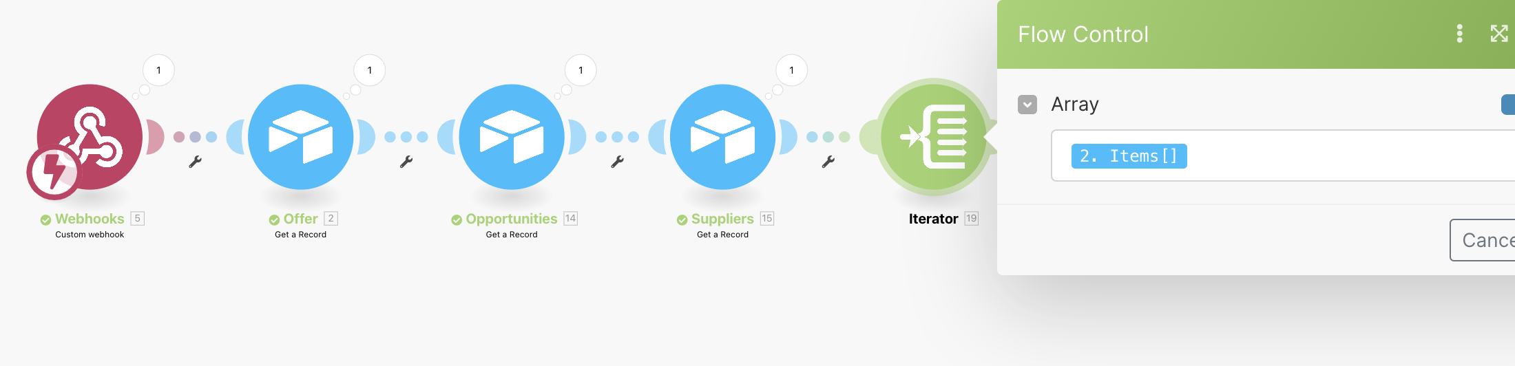

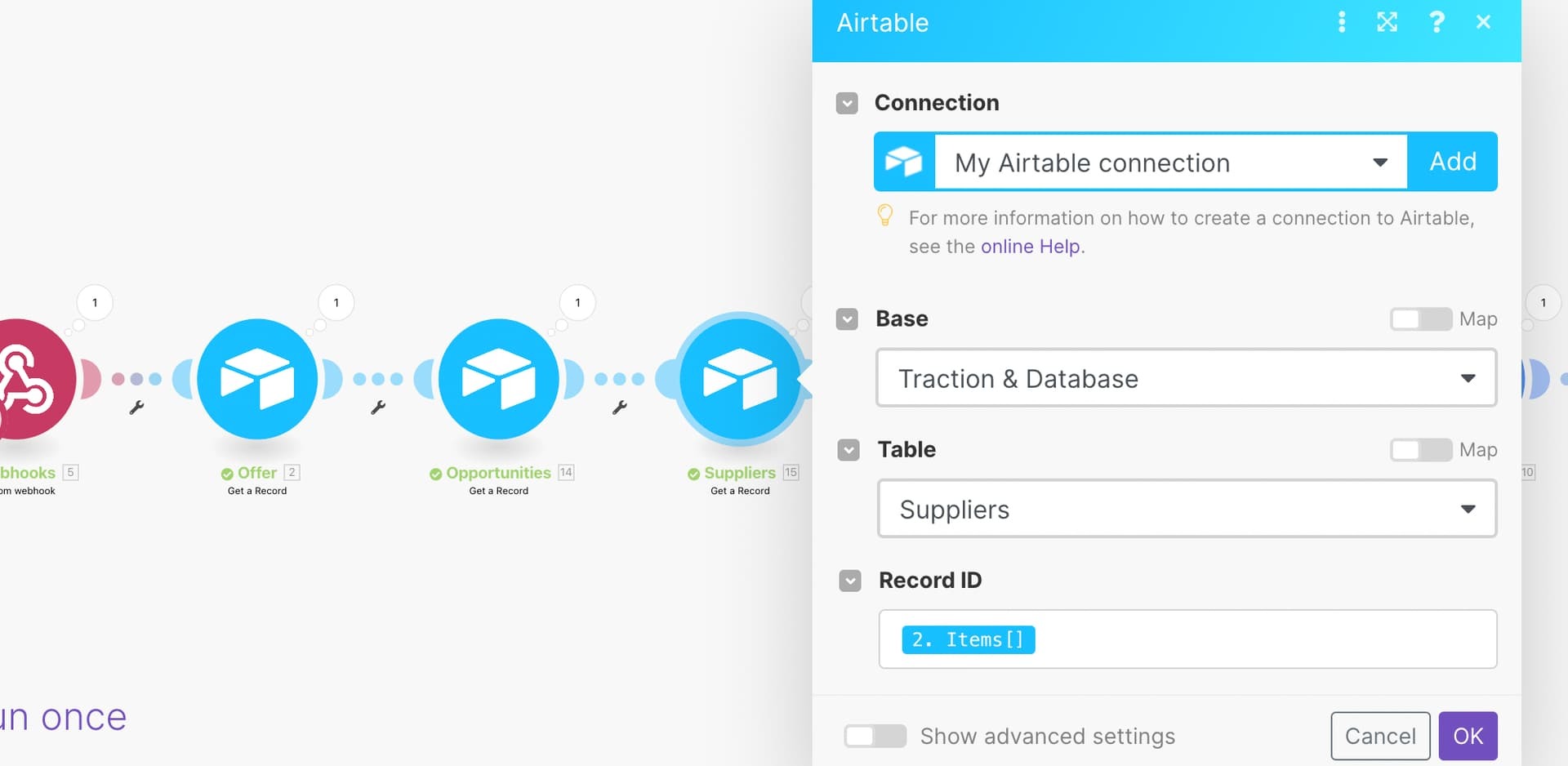

I’m not quite sure where should I use the Iterator. This is my scenario now. I just added Iterator. Should I iterate what I am currently using as a Record ID in Suppliers or?
