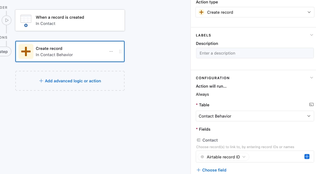

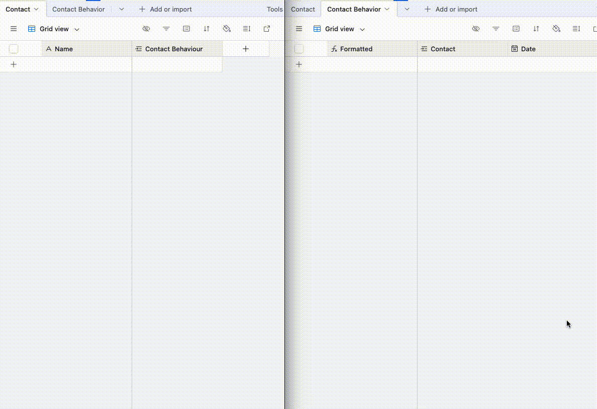

Does this look right?  If so I’ve set it up here for you to check out
The automation triggers when a record is created in Contact, and creates a new record in Contact Behaviour, linked to the original contact record:
As the records are already linked, there’s no need to create a text field in Contact Behavior to store the name, we’d add a lookup field to pull over any data that we wanted or use the linked field value if that worked, does that make sense?

Damn ​@TheTimeSavingCo, coming in off the top rope with the perfect solution, using RecID to create and link a blank record that is titled via formula. 💯
