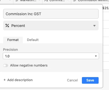

Hi AT Community,
I'm creating an automation email within Airtable that uses percentage field data from my table.  I have set the precision to one decimal place (1.0) in the field column.
However, when testing the automation, the preview shows that the token data percentage with 10 decimals (1.000000000), which looks ridiculous.
Anyone know why this is happening?
I know the workaround is a single-line entry, but I'd prefer to be able to enter the data as the percentage number, as that's how the information comes to us.
Appreciate your help!
