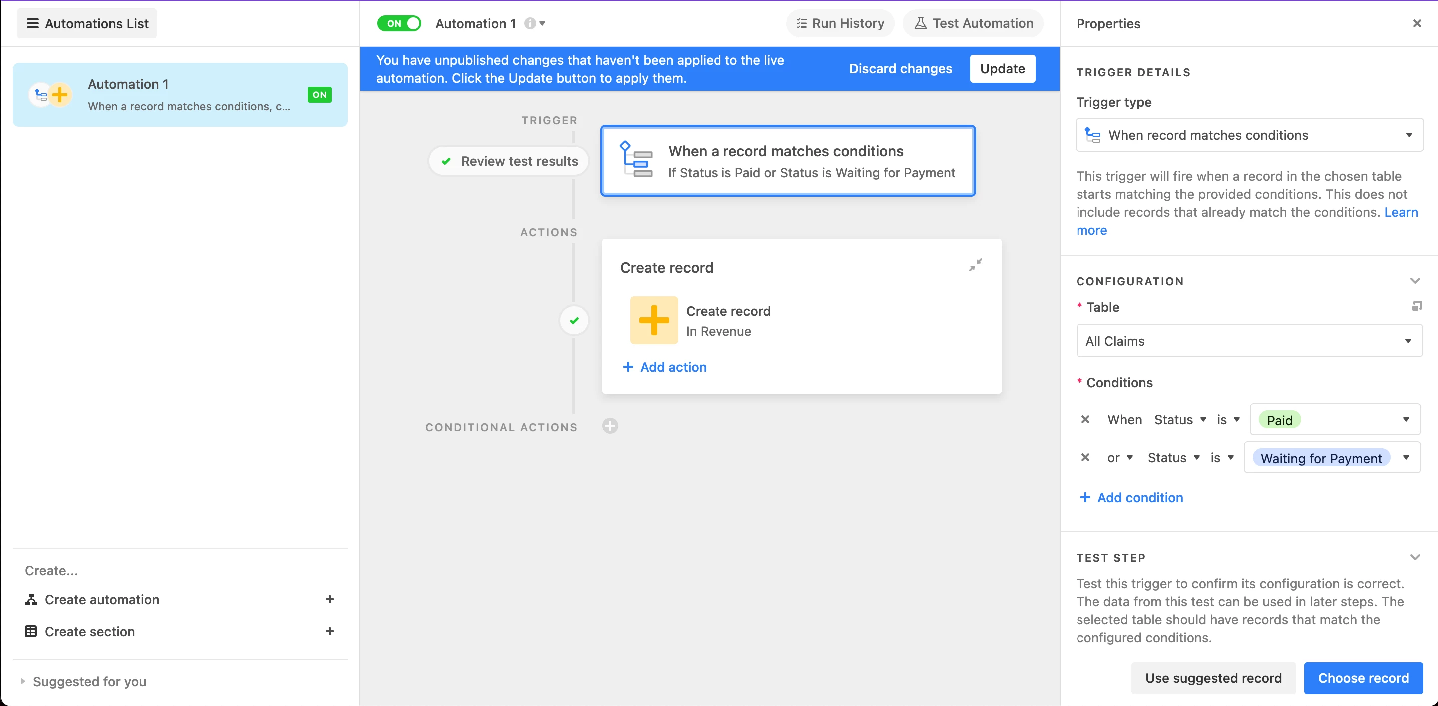

Thanks for your reply.
Thats what I tried doing but had no success yet. Maybe I am doing something wrong. This is what I tried so far to no avail:
1. I set trigger that for every item on the table that matches the condition "Paid"
2. I create an action that creates a record in the "Income (claims)" row as shown in the image
However, when I do this, the automation asks me to select 1 item from the list of items meeting condition in 1.
What I want is that once the condition is met, all the items are added to the table.
Maybe I am using the wrong action? I tried all the other, but none gave me the output I was looking for yet.

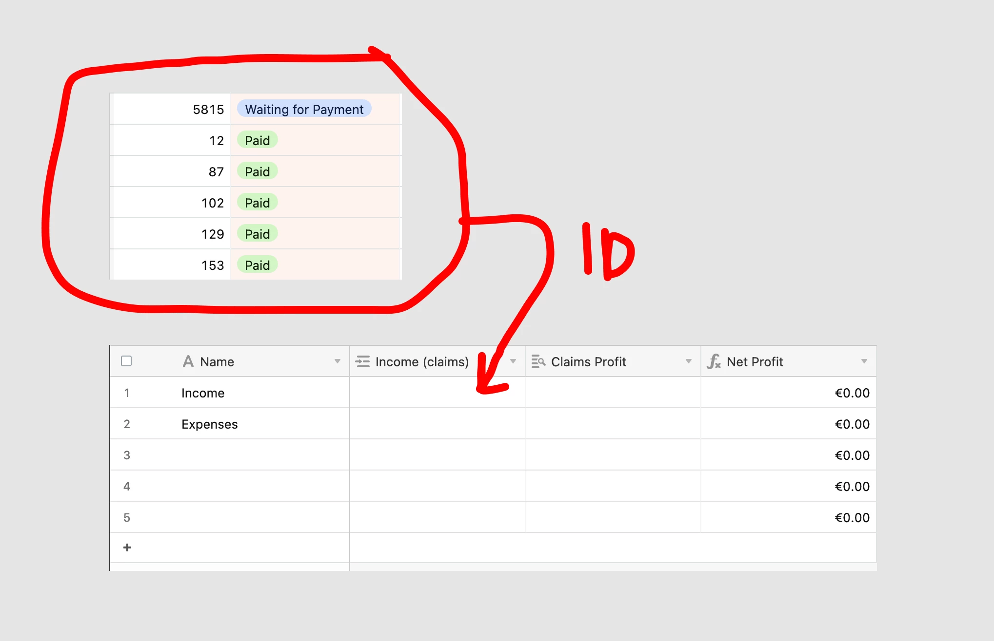

Thanks for your help.
Follows 3 screenshots that might help you understand what I am trying to do.
I also include a screenshot of the table format I want all the claims to be added -- if conditions are met, their ID should be added to "Income(claims)" cell

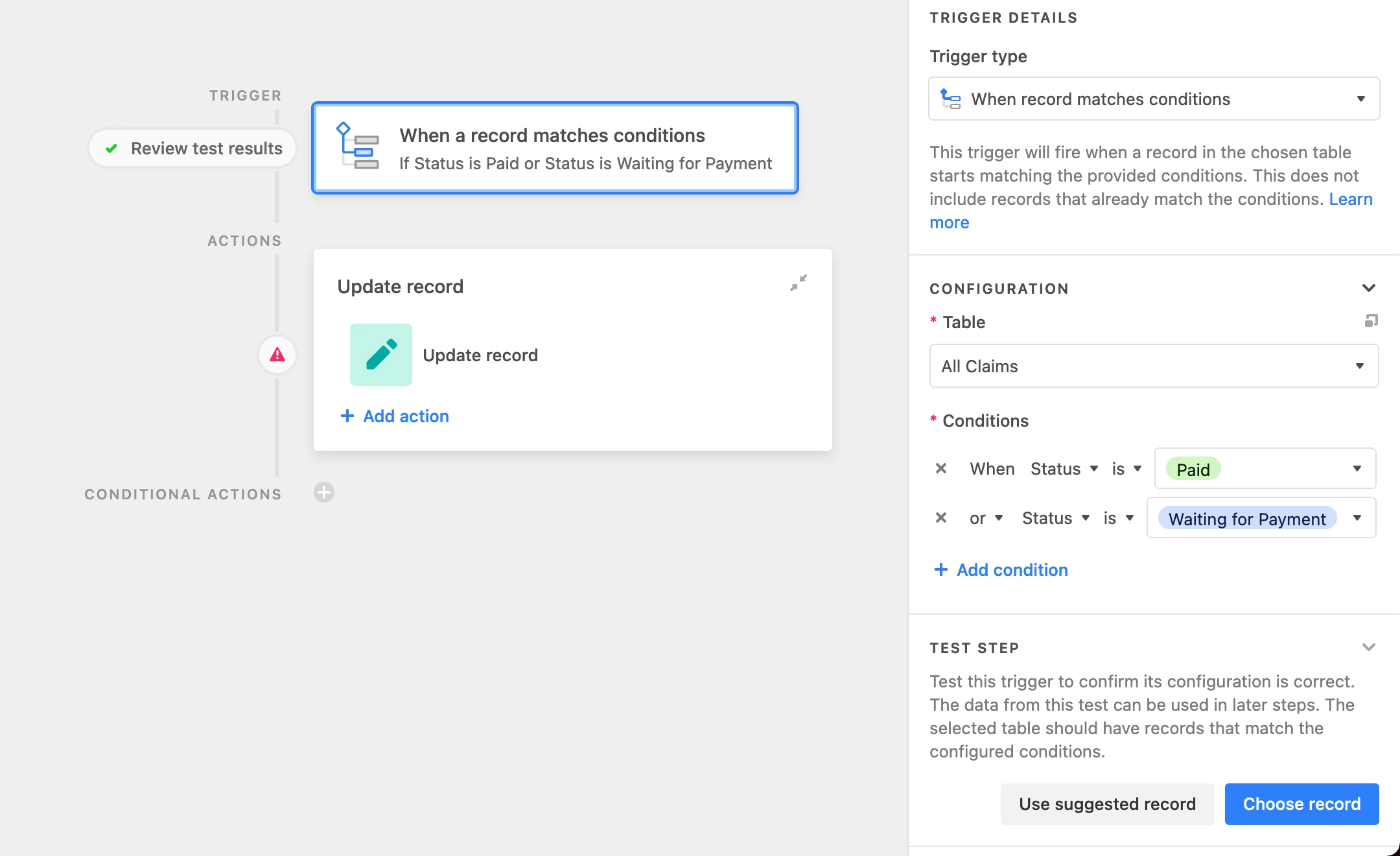

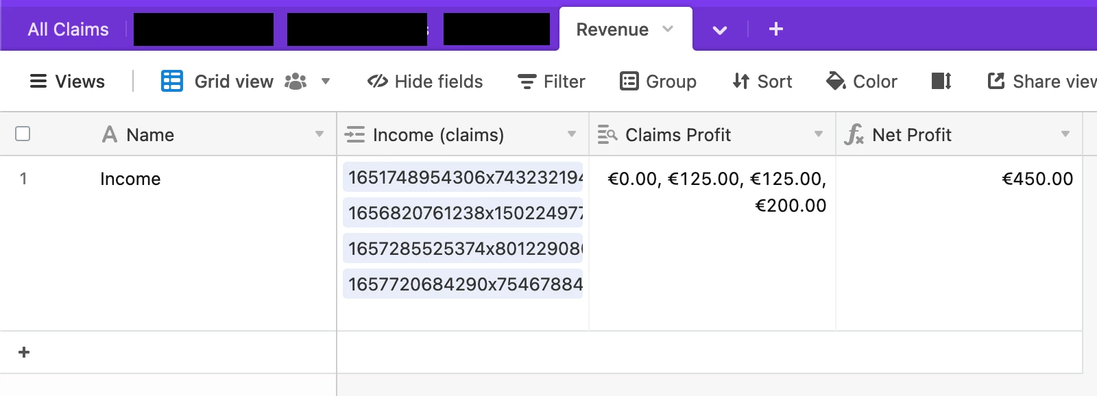

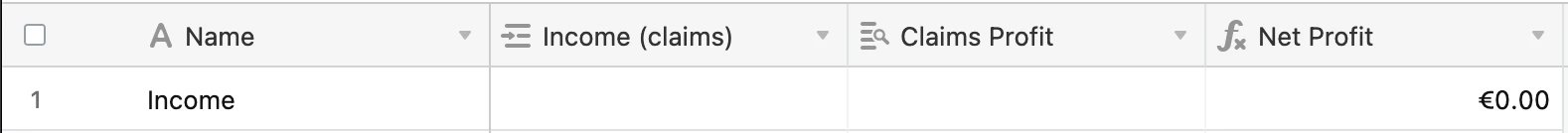

  1. Currently, there is a main table (🔗main-table.png) where all the important records are kept. The most important thing in this table (for this automation) is the Unique ID and the Status of the claim.
  2. My goal is that when a claim status turns either Waiting for Payment or Paid, the unique ID of this record is sent to the Revenue Table via a table Link input.
  3. So, upon triggering (🔗trigger-all-claims-status.png -- which seems correctly set up), all the records matching the conditions above would be linked to the revenue table cell, just like its showing in "🔗revenue-table.png" (all together under a cell. Added them manually for reference only).
  4. At the moment, the solution you proposed looks like "🔗output-revenue-table.png"
Curious to know if this description is easier to follow 🙂
Thank you so much

Ahh thank you for the explanation and your patience
In the image `output-revenue-table.png`, the "Update Record" action is for a record in "Revenue".  Could you try changing it to the table "All Claims", leaving the record ID field the same, and making the value for the linked field to "Revenue" be "Income" please?
