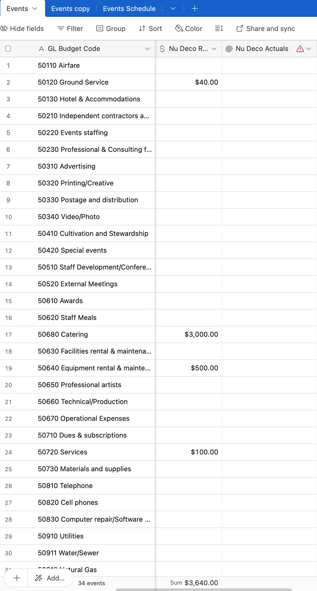

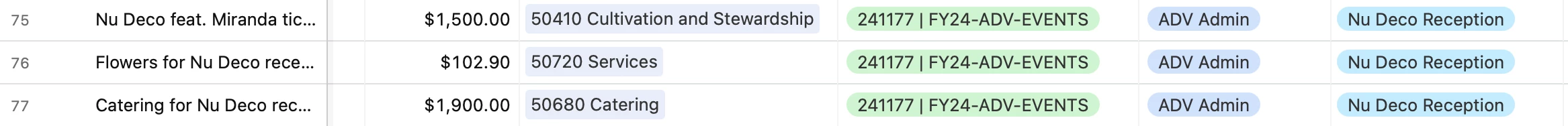

Hi! Thank you SO MUCH for taking the time to respond. The budget summary is divided into "budget codes", i.e catering, services, ground service etc. For example, our Nu Deco event. The first image are 3 entries in the "all expenses" tab that is coded correctly by budget code, event etc. The second image is the Nu Deco portion of the budget summary tab. You can see what was budgeted and then in the actuals column there is a red triangle and none of the numbers entered for Nu Deco in the all expenses tab have carried over. I really REALLY appreciate your help!

I'm assuming you've got it set up so you're just linking each data entry to the particular event it belongs to. If all you're trying to achieve from here is to find the sum of a specific field, try using SUM(values) in the rollup formula?
Here's an article to reference for more info on rollup fields:
https://support.airtable.com/docs/rollup-field-reference
