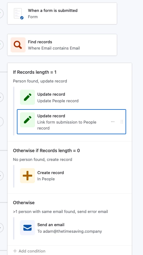

That said, there are ways to utilize automations to achieve some of what your looking for. First off I find it helpful to separate your form submissions from the rest of your data, rather than form entries going right into your data tables. Then it’s all about using the Find action in automations along with conditionalities. So you make an automation that is triggered when form is submitted, find records in Project Table where Project Name = Form Project Name. If Records is not 0, edit record found to update, if Records is 0, create new record. Super simple to add a send email action at the end too as an alert for staff.

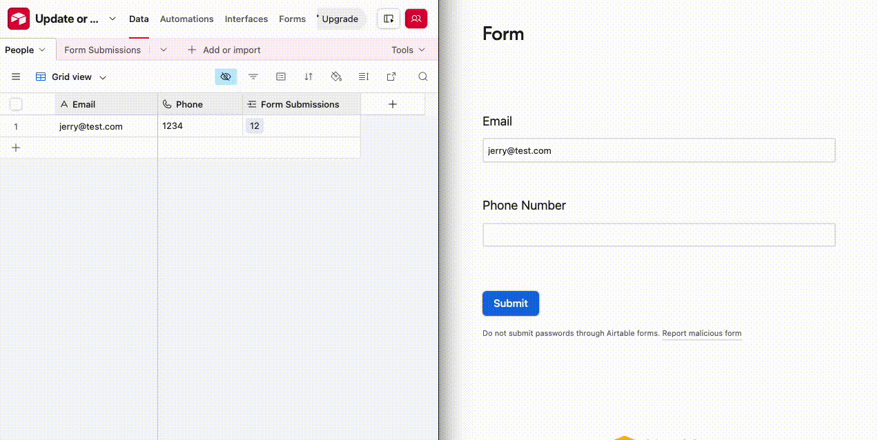

There are several methods to achieve this:
 1. Extension: Use the “Dedupe” feature to select fields for identifying duplicates, then choose to either merge or delete them.
 2. Simple formula: Create a formula to identify duplicates and perform the necessary cleanup.
 3. Automation with script: Develop a script to output duplicates, update records, send notifications, or perform any combination of these actions.
Airtable has a guide on how to update records via form submissions that you can find here: https://support.airtable.com/docs/use-case-update-records-via-a-form
The idea is to use a Find Record step to look for the original record that needs to be updated, and I echo what DisraeliGears01 mentioned about emails being the safest option for duplicate checking
You can extend this functionality using conditional logic to handle record creation if it doesn’t exist as well, and I’ve set that up here for you to check out.  Here’s how it looks in action:
 And here’s how the automation looks:
