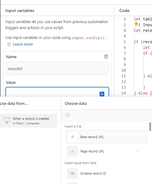

Hello everyone,
I did a trigger "When record is created" and script action where i want to get the record id to be able to update the record and all stuff. To do it, I'm using input.config() but not doing well in input variables. As shown in the picture, I've created an input variable named recordId and the value should let me choose something like "Record (from step 1)" that should be the record id of the trigger. I've never used this before and I'm a bit lost. Thank you all in advance.

Pick "Airtable record ID", the third item in the menu in your screen shot, to get the record ID.
The "Use data from..." section lets you pick the triggering record or a previous action, if there was one. Then the "Choose data" lets you pick which specific piece of data from the triggering record or previous action.
It's very similar to Zapier, but the terminology is slightly different.

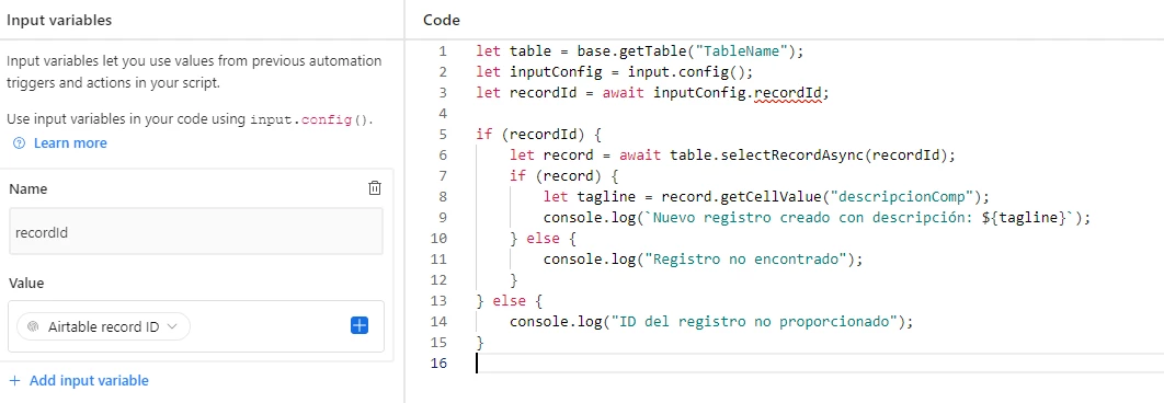

Thanks for your fast reply! I've just picked "Airtable record ID" but there's still an error in declaration of the recordId.
  • July 30, 2024
Sometimes the editor puts in wavy red underlines even though the script runs fine as is. This may be the situation. Also, sometimes the editor takes a while to catch up to changes in how input variables are defined and sometimes the wavy red underlines disappear after closing and reloading the editor.
Try running the script and see if it does what you expect.
