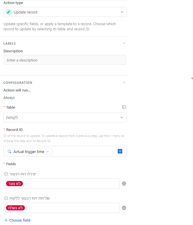

I'm trying to create automation that every scheduled time 2 fields in the table will be updated to certain status.
the trigger is working but i get an error of "Received invalid inputs."
can anyone help me with this?
attached image that show the automation:

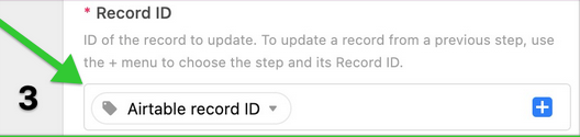

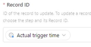

Ah that's because you're using the trigger time for your record ID value:
You need to use the record ID instead:
Airtable has a good guide you can find here: https://support.airtable.com/docs/use-automations-to-timestamp-status-updates

I cant, this is what I see - https://imghostr.com/e0064e_u96
You're going to need to add a "Find Record" action so that you can tell the automation which record you want to update.  If the record you're trying to update is always the same you can just key it in manually though!  To do that, create a formula field with `record_id()` and use that value in your automation
I still get the same message - https://imghostr.com/ed1682_o4a
