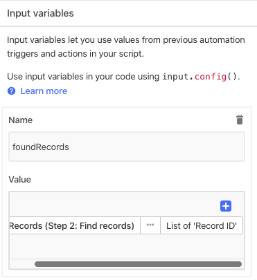

Not necessarily. The output can also be sent to a script action which can operate on the group of found records. That’s what I would recommend in this case.
After making the script action, add an input variable that contains the list of record IDs from the “Find” action:
Here’s a sample script to update the found records:

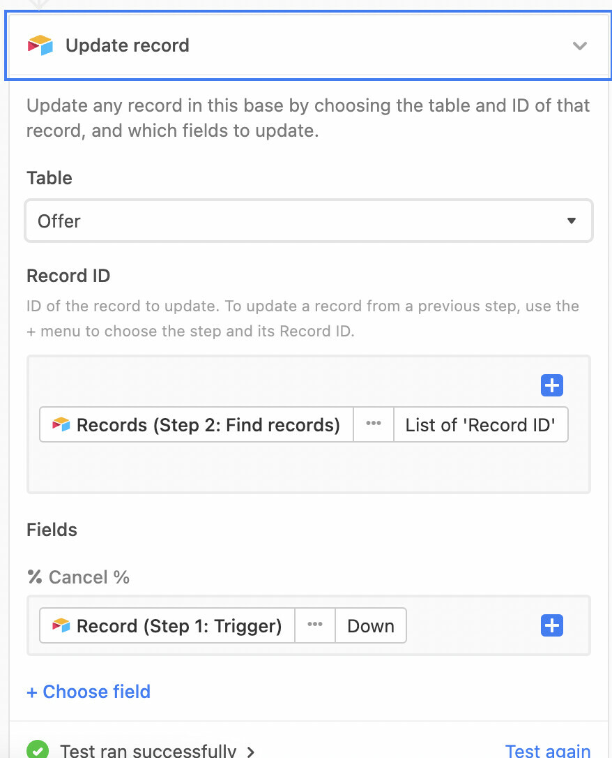

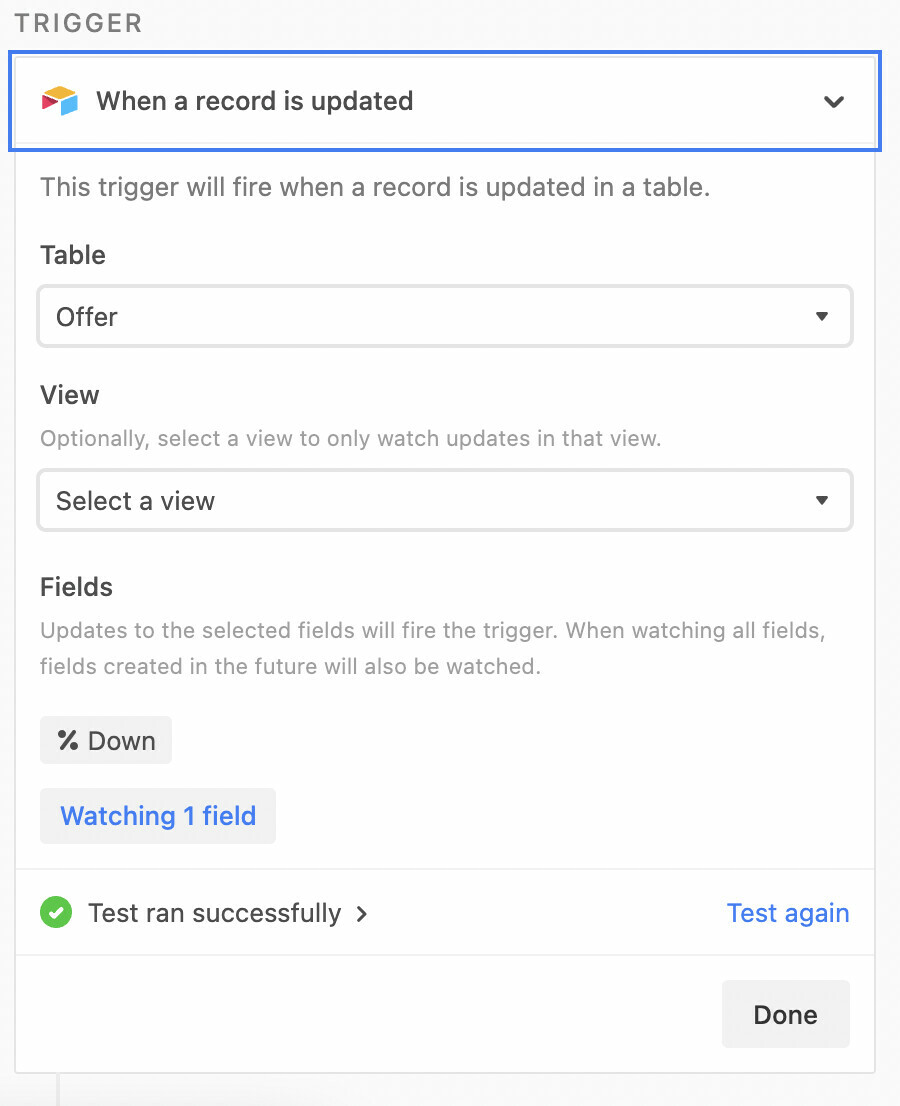

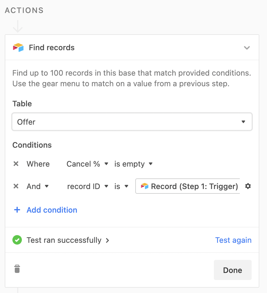

@Pjero_Kusijanovic : could you please share some screenshots showing what you tried? The documentation says that your process should work, but perhaps it wasn’t set up correctly.
Forum|alt.badge.img+10
  • March 7, 2021
Sure, here I will explain in more details.
So, the trigger is updated {Down %} field…
Next is the action find record, looking if the {Cancel %} field (the field that I want to update in next step) from the record in the previous step is empty.
This should update {Cancel %} with a value from {Down %} only if the {Cancel %} is empty.
Now, if the {Cancel %} is empty everything works fine and the field is updated, but if the field {Cancel %} is not empty I get “Failed to run” error. Not sure why the error appears when, there are 0 results in second field with {Cancel %} not being empty?
Hope this explains well.

That (that part that I highlighted in bold) is precisely why the error appears: the Find action isn’t returning any records, so the Update action has nothing to do. In essence, you’re trying to implement a conditional update, but automations are not yet designed for conditional behavior. They only work when every step is executed successfully. When one step fails, the whole thing fails. In this case, zero results in the Find step causes the Update step to fail because there’s nothing to update.
In the end, the problem isn’t with passing the results from the Find action to the Update action, because that works when a record is found. The real problem is with the overall design of the automation. A more appropriate design would process the conditional test before triggering the automation, so that the automation runs only when needed instead of running every time that {% Down} field is changed.
Before I recommend an alternative approach, I want to make sure that I understand your process clearly. As I’m reading it, you’re entering values manually into {% Down}. The first time that this happens, you want that number copied into the {Cancel %} field. If {% Down} is changed later, you want {Cancel %} to remain as it was. Is that correct?
