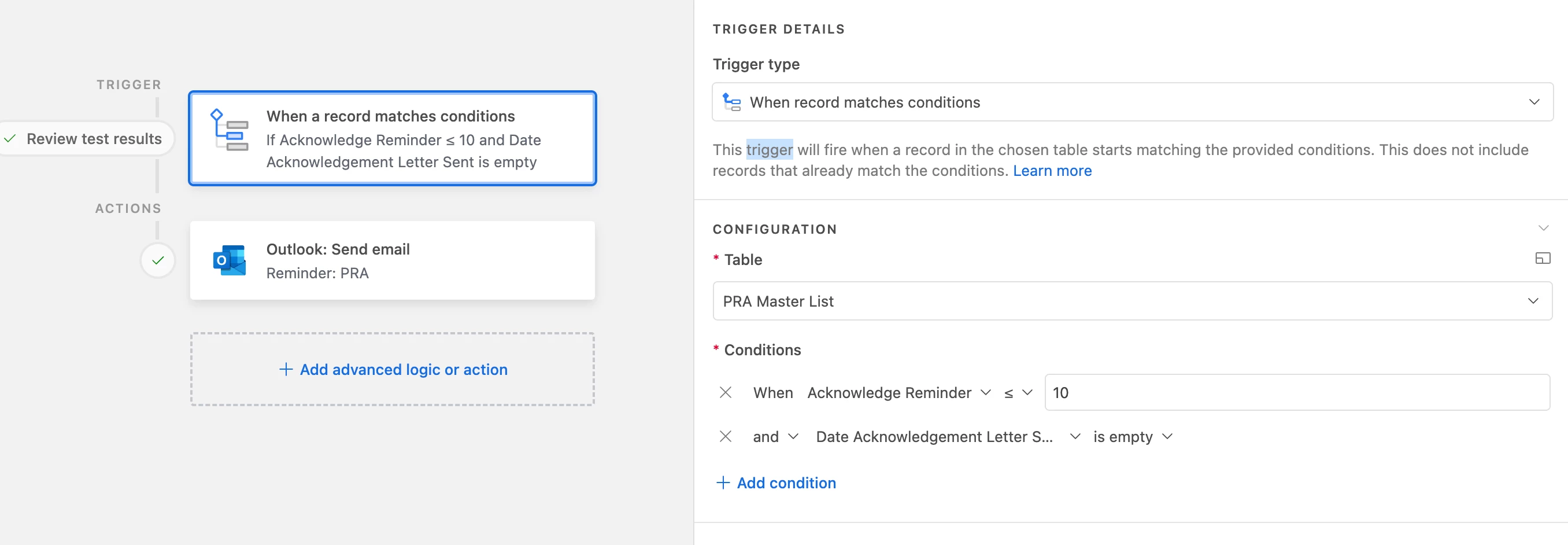

I have two automations set up that send me reminder emails when my records hit a specific date condition.  It is a "days remaining" type of condition.  I want to wake the base up every morning so that it can update the records and send the appropriate reminder emails.  Do I need to have the schedule automation first in the list so that it performs that first or does it not matter?
These two automations that I have run off of DateTime_Diff but I only get the email once, at its creation.  It doesn't send me one as the days progress to zero.  Here is the formula in the field:
IF(DATETIME_DIFF({Deadline to Acknowledge}, TODAY(), 'days')>0, DATETIME_DIFF({Deadline to Acknowledge}, TODAY(), 'days'))
I attached the automation. Did I set something up wrong?

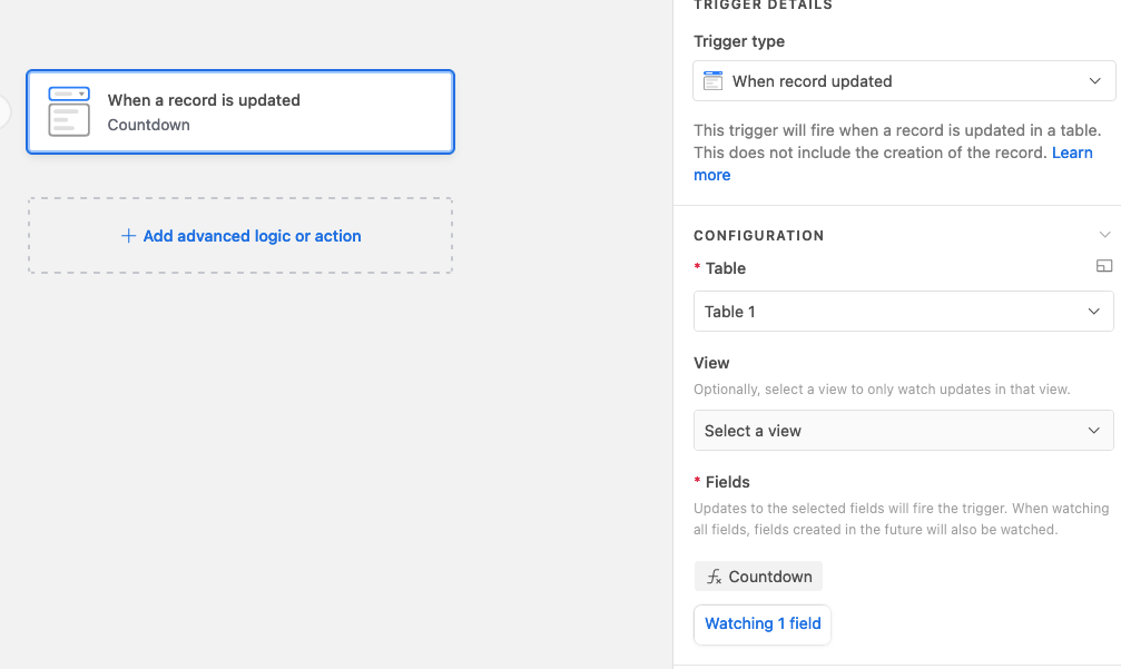

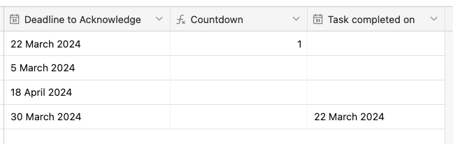

That is perfect.  But one question, the countdown needs to stop once another date field is filled in.  For example, I have a deadline of 10 days to complete a task.  I want a reminder each day until I can complete that task with 10 days.  Five days before the deadline, I complete the task and enter the date of Task Completed.  I no longer want to receive emails because the task is completed. Is that an easy add to the formula?
Oh yeah for sure, just add a check into your "AND" to see whether that date field is empty:
IF( AND( DATETIME_DIFF( {Deadline to Acknowledge}, TODAY(), 'days' ) > 0, DATETIME_DIFF( {Deadline to Acknowledge}, TODAY(), 'days' ) < 11, {Task completed on} = "" ), DATETIME_DIFF( {Deadline to Acknowledge}, TODAY(), 'days' ) )

I was able to get the email reminder when the number of days remaining changed but it changed at 5:00pm PST and I found out that AirTable uses GMT time zone.  How do I add to it that I want the update to happen at 7:00am PST?
Hmm...I think you could try calculating the hour difference between 12am GMT and 7am PST, and using DATEADD in your formula?  Should work theoretically and I've just set up my own version of this automation to test it out, will let you know!
Yea this appears to work I think.  I don't think we can get it to do 7am exactly though

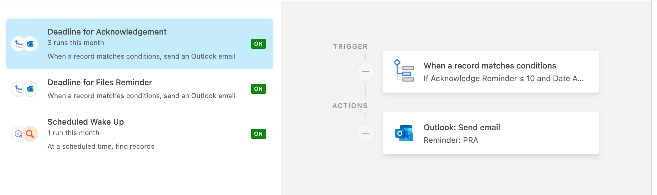

What if we had an automation that'd run every day at 7am instead?  That automation's action would be to find records where Countdown < 11, and we'd use a repeating group to send one email per found record?
  • Mar 25, 2024 3:58 PM UTC

Seeing as you want it to be at 7am I don't think you should write the formula, and I think you should try setting up an automation that runs every day at 7am instead!
I'm not sure what you mean when you ask about the order of the triggers?
