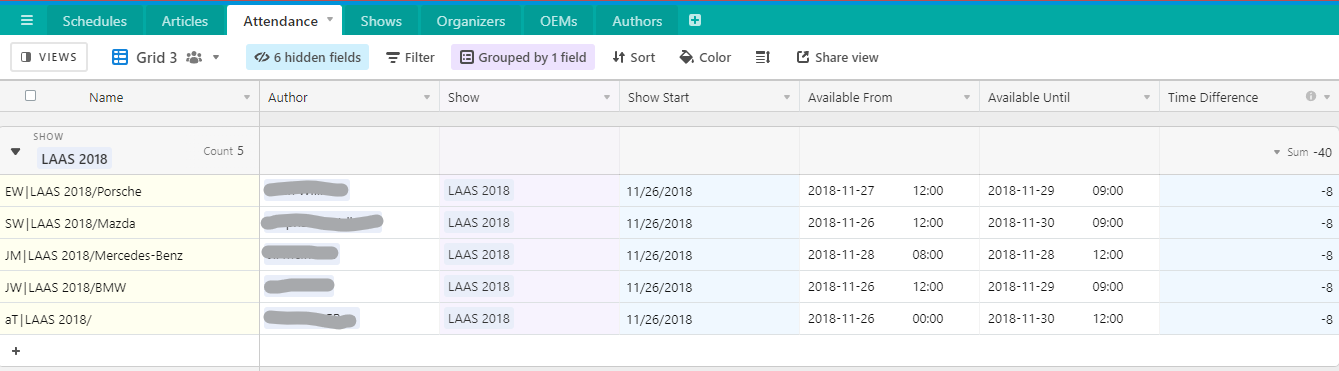

Haha, here’s what the Attendance table looks like (I’ve hidden a few fields for clarity):
I have a few more tabs (not only are people working at the show, but they also have stories to deliver), but the important ones are Attendance (=Schedule), Author(=Staff), Show (=Events).
As for my tips from earlier: I have my records grouped by Show, so each new record created in that group will automatically have the Show field filled in (in this case, with LAAS 2018). If I create a record in a different group, I’ll be able to copy the Author names from this group and paste it into that blank record and Airtable will create new entries to accommodate the pasted data.

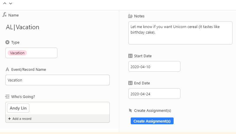

As for changing the automation to a script, here’s an example from a different base:
When I click on “Create Assignment(s)”, it creates a new article entry (different base, but the equivalent would be an entry in Attendance/Schedule) for every entry linked under “Who’s Going” with the start and end dates (and since they’re copied into regular date/time fields, they’re independent from this event record). Functionally, it’s exactly the same as an automation, but since I control when the script runs, I don’t have to worry about the automation “catching” only the first person I enter, and having to wait however long it takes for the next run.
Mind you, the reason why I don’t have a similar button for the Auto Show table is that I would still need to change details in each of the additional records, so overall, I’d only be saving time entering people’s name into the Attendance table, and that’s… the same amount of time I’m spending entering them into the Event table. The only benefit is the direct link between the Staff and Event table, so you can click on the name of someone working an event and get taken directly to, say, their contact info, as opposed to first hopping through their schedule entry.
