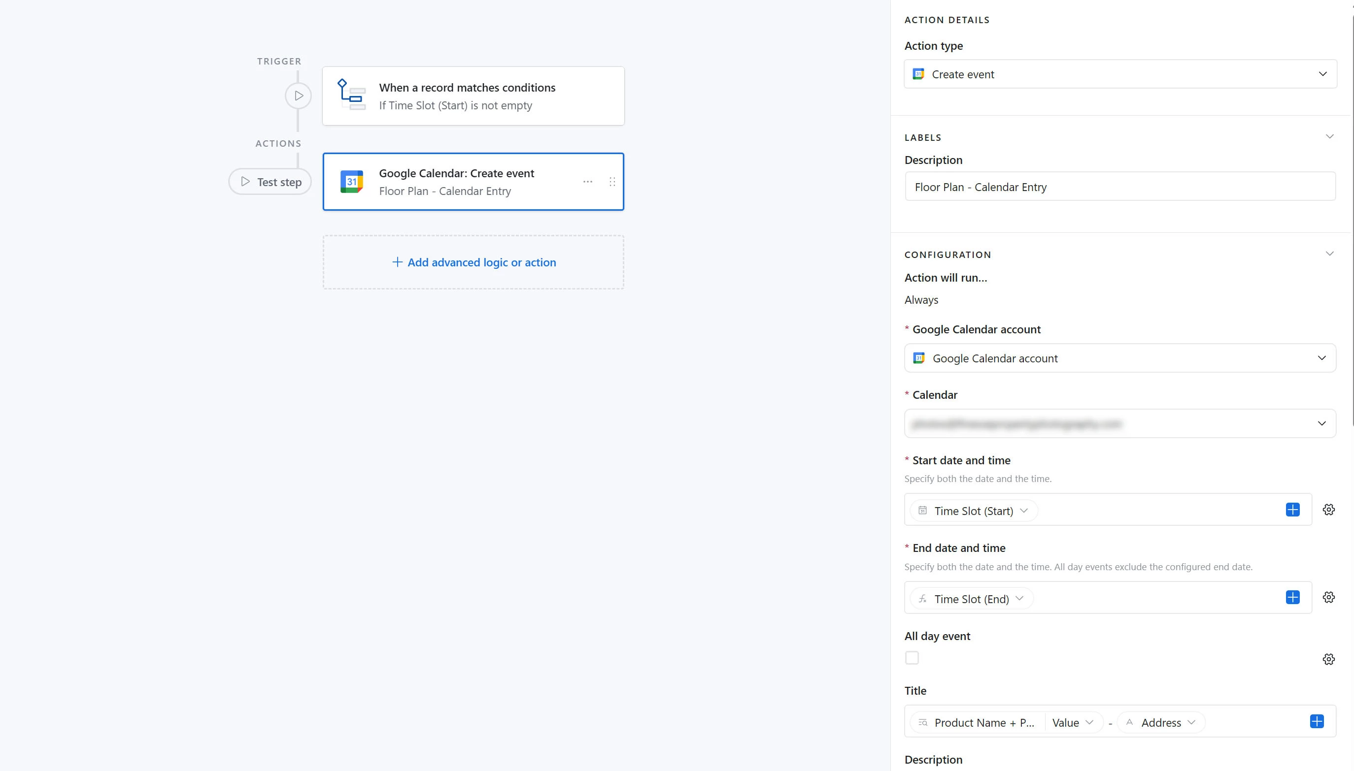

I was hoping I might have some help with an Automation please.

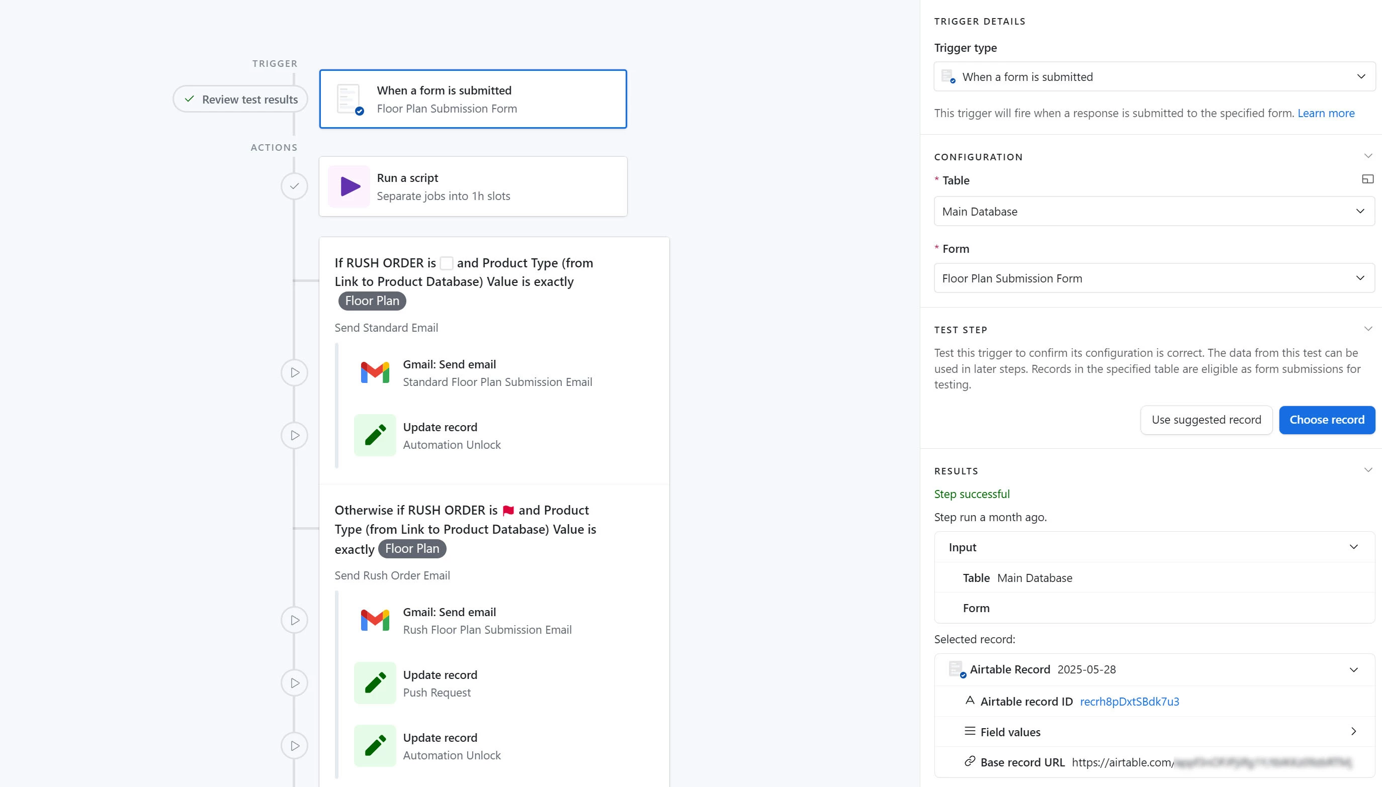

I’ve been working on an Automation that will allow people to submit job requests via a form, and then have these jobs appear on my calendar for my accountant to reference.
The automation works off a number of fields and a script per below:
When a form is submitted > Run a Script
The script looks at what day it is, and starting at 10:00am in 1h blocks will add jobs to the calendar that day as long as they are before 9:00pm.
Jobs falling after 9:00 pm will be pushed to the next business day, and anything on the weekend is pushed to Monday.

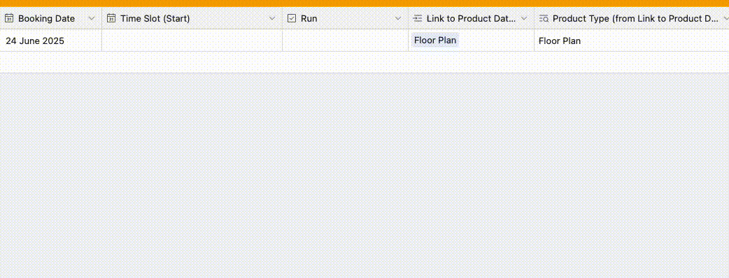

The script also look for a specific job type (floor plans) so that only they count towards the slot number (10:00-11:00am, 11:00-12:00pm etc).

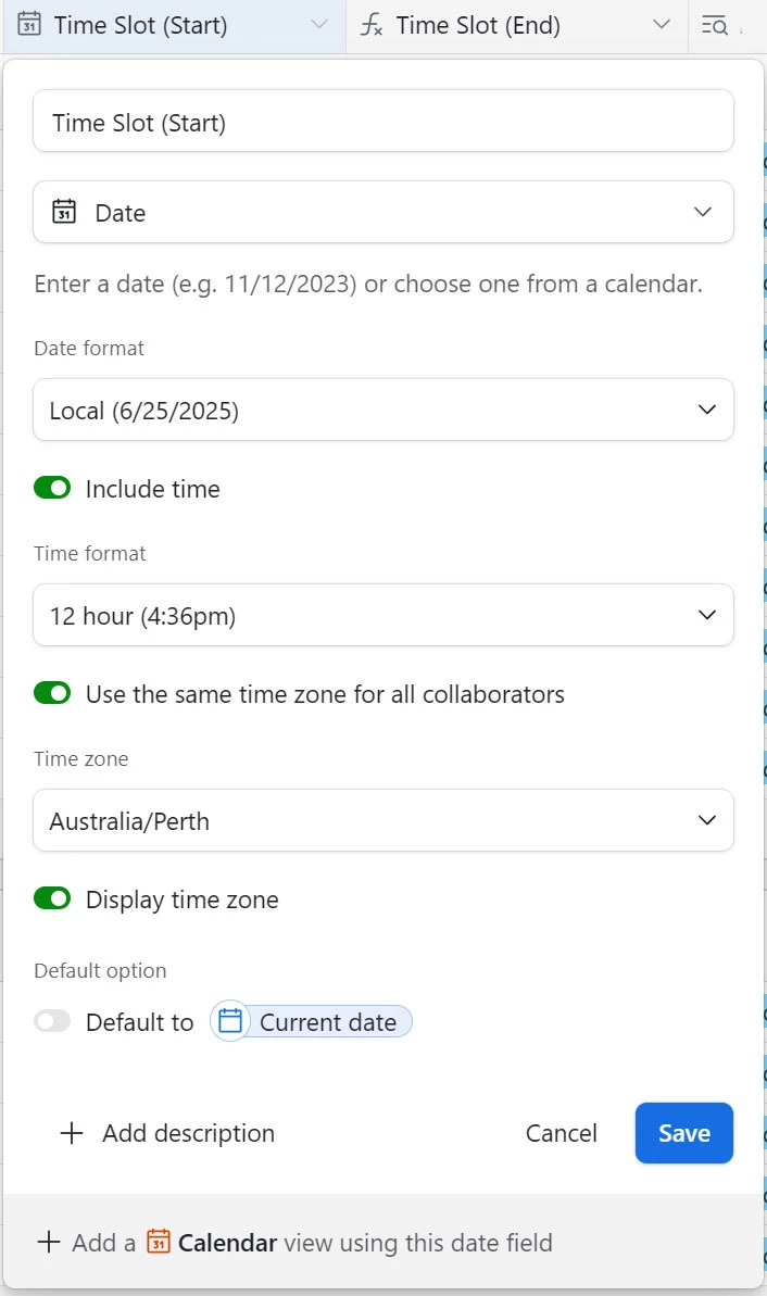

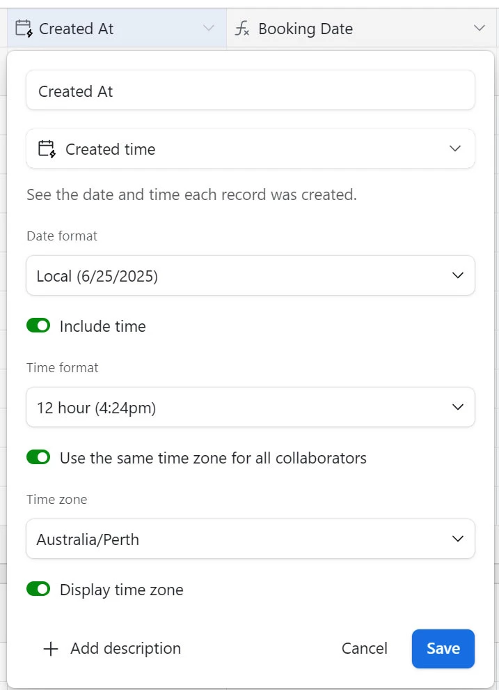

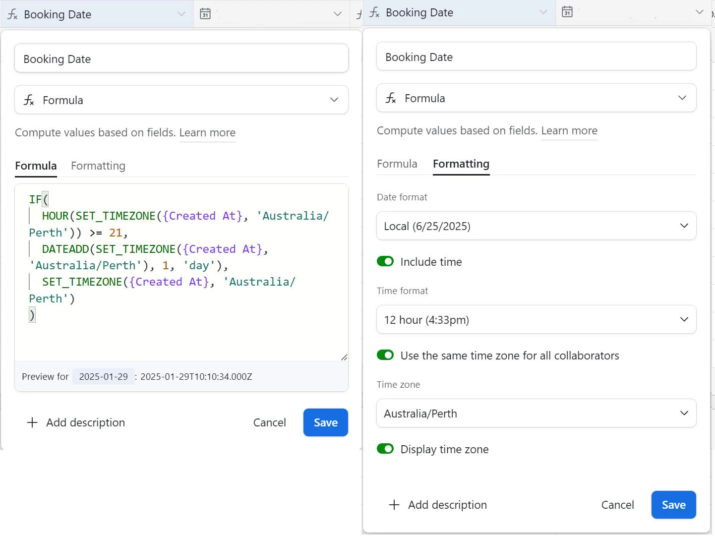

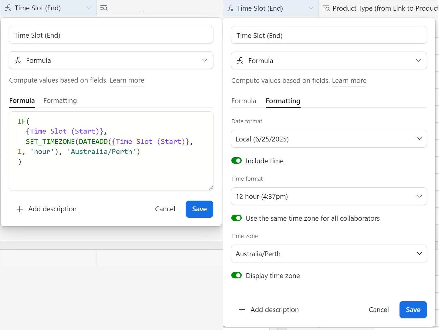

As best I can tell, anything relating to the timezone of the automation and formulas it ties into is set to “Use same time zone for all collaborators” with the zone set to “Australia/Perth”.
However, for some reason the first slot always seems to default to 6:00PM on Airtable.
I’ve spent some time trying to make sure everything’s done correctly but I feel I might have missed something. I’m using a script that was given to me so there might be something in there that is causing the issue too.
Below is the script and screenshots of the automation and formulas. Any ideas? Your help would be massively appreciated! Note: I don’t personally know how to script.

When a Form is Submitted
Add it to the Calendar
Job created at Date/Time
Booking Date for Calendar (9:00pm deadline)
Time Slot Start (For Calendar Automation)
Time Slot End (For Calendar Automation)

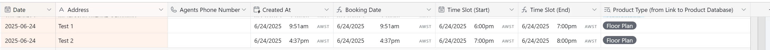

Example Order (note 9:51am entry results in 6:00pm slot)

Does this look right?
If so, I’ve pasted the code below.  I forced the date creation to be UTC, set it to 2am UTC which is 10am Perth, and then added an offset at the end.  There’s probably a more elegant way to do it but this seems to work fine
