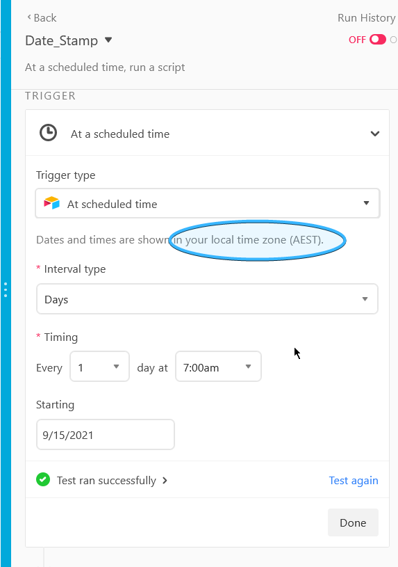

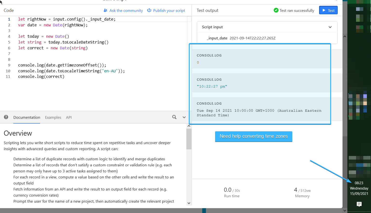

I’m not too sure where I’m going wrong. The Javascript examples I’ve read indicate that this should work, but Airtable isn’t processing them as I’d hoped - and judging from the results I’ll need to modify my script somehow.
Although the Automation triggers at the correct local time, it certainly doesn’t pass the local time as an input into the script - which isn’t a problem so long as we can easily process it to the correct time within the script, which is where I’m stuck.
//Trigger executes 7am daily and provides the _input_date to the script, but it is using yesterdays date (even though Airtable trigger states it is using local time?), so attempting to align it with local time via JS below
let rightNow = input.config()._input_date;
var date = new Date(rightNow);
let today = new Date()
let string = today.toLocaleDateString()
let correct = new Date(string)
console.log(date.getTimezoneOffset());
console.log(date.toLocaleTimeString('en-AU'));
console.log(correct)
Appreciate any help. This is messing with me big time. :face_with_raised_eyebrow:

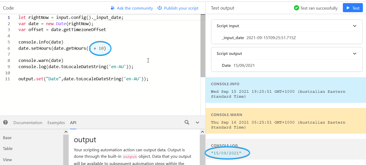

Ahh cool, thanks for reaffirming @kuovonne of what’s going on under the hood. So with all this in mind, and a little further reading on parsing time, I have my script almost working but with only one outstanding question;
You can see that I’ve hard coded +10 hours onto the GMT time - however the plot thickens in that I’m needing that value to accommodate both +10 and also +11 hours due to local daylight-savings. Is there any straight forward method for doing this? getTimezoneOffset returns 0 as I assume it’s calculating the offset between GMT/UTC and GMT/UTC which obviously evaluates to zero.
If not, I’m guessing I’ll need to write a function that checks if the date range is in between the first Sunday of April and the first Sunday of October…

Thanks @Bill.French - I wish that worked, but I suspect that the code is comparing GMT/UTC with GMT/UTC and thus returns zero. I’m hoping there’s a command where I can just feed in the AEST/AEDT value to have either 10 or 11 returned (depending on time of year).

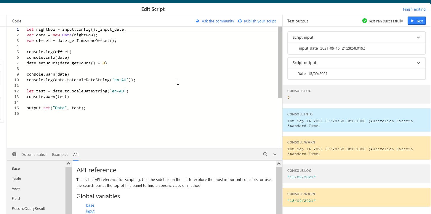

Here’s another screenshot showing the confusion;
In isolating the problem, it seems that when I call date.toLocaleDateString(‘en-AU’) that it’s;
  • ignoring my local time (7:30am) and instead using GMT
  • formatting the date to local date format (which is good), but then using the GMT time that changes today into yesterday which it absolutely shouldn’t be doing!

If that’s what’s happening then your browser/PC is [incorrectly] indicating your current locale is GMT/UTC. Is that where you are located? I suspect not and here’s why your methodology is failing.
You need to extract a date/time that is unrelated to “rightNow” - try the code I pasted above. It uses a new Date() method to give you the actual time in your locale which should not be influenced by anything except your computer’s TZ location.
