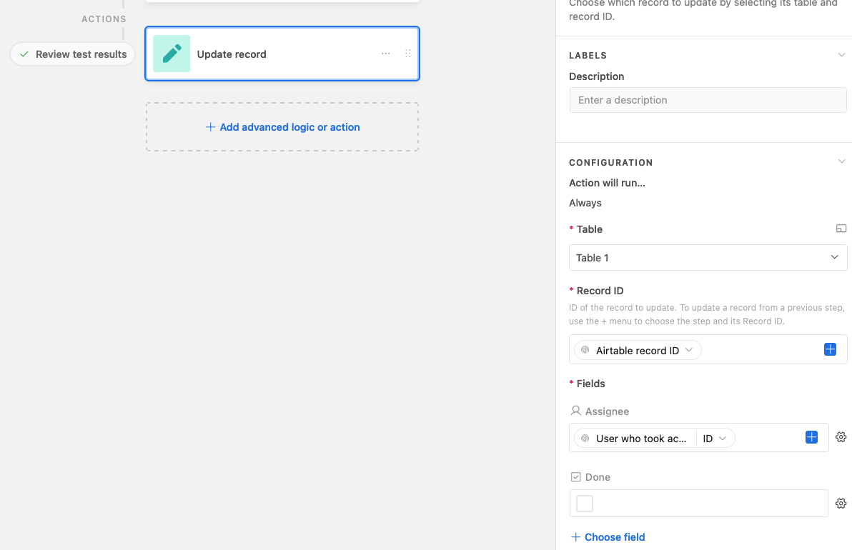

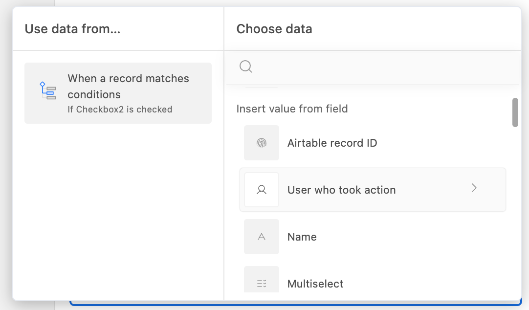

That's the old way of doing it.
The new way is using Airtable's new automation option: "User who took action".
See screenshot below.

Interesting!  You're able to update a "User" field with the values from that?
  • Apr 4, 2024 3:25 AM UTC
Yes, you can update any editable field with that.

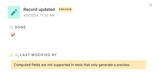

Interesting!  I tried to do that originally but couldn't get it to work; when I run the test it never shows the "User" field and just figured it was bugged or something:
Tried it with "User Type", "ID", "Email" and "Name"
Could you tell me how yours is setup differently?
  • Apr 4, 2024 3:50 AM UTC
For some reason, it won’t work if you run it as a test. You actually have to trigger the actual automation for real in the base.
Yeah you're right, I triggered it manually and it works fine.  That's....so weird
Thanks!
