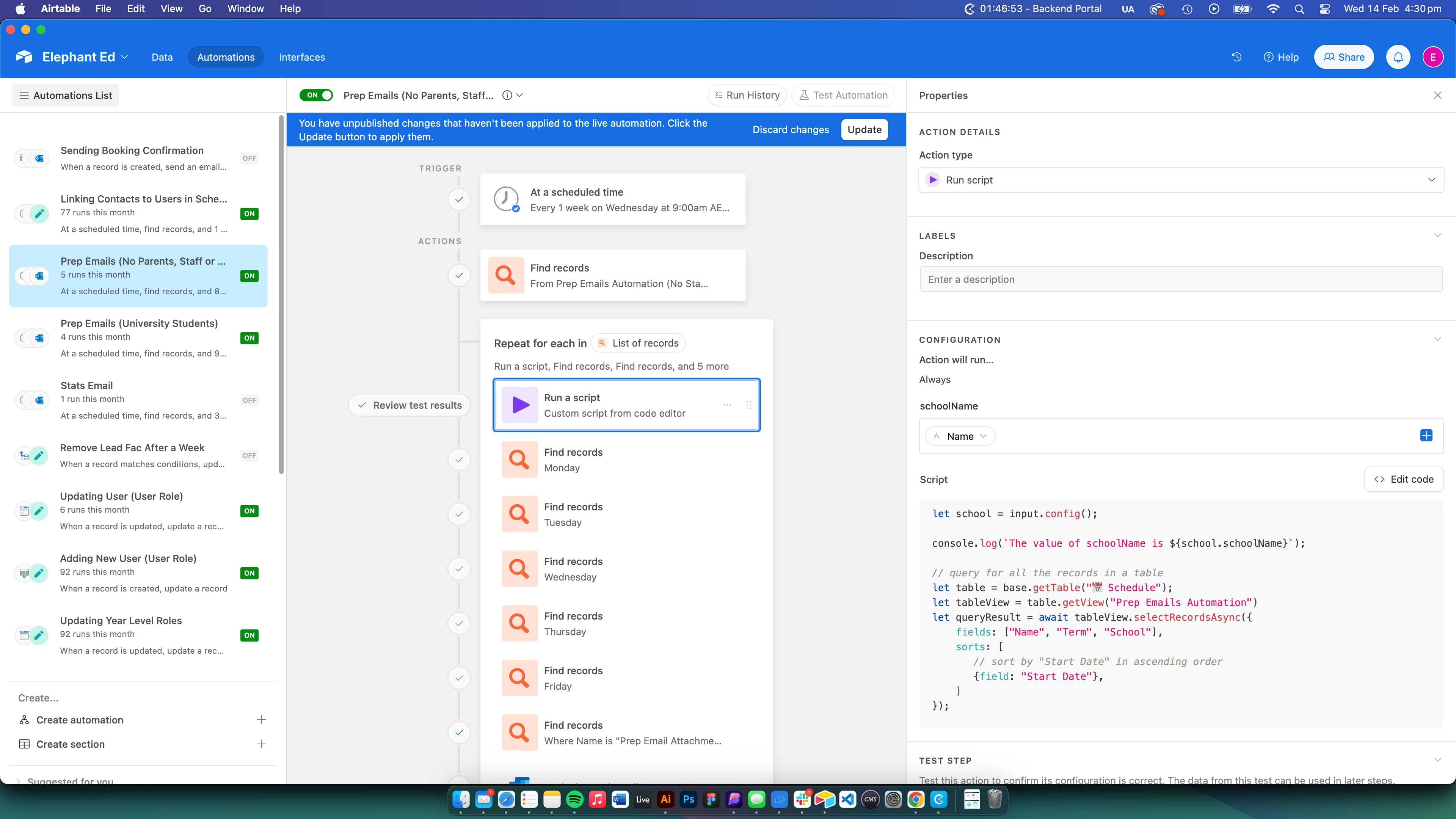

In my automation I am finding a list of schools and then using a repeating group to go through each school and find values where the school is in the schedule table. I am running a script in this repeating loop to get all the entries in the schedule where the input value is from the schools. I am doing this so I can then order these according to start date which Airtable doesn't let me do.

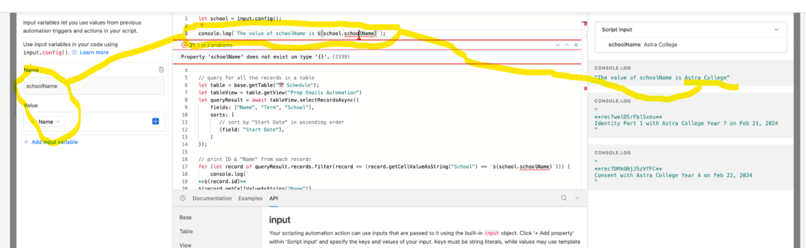

You can see my automation in the attached screenshot.

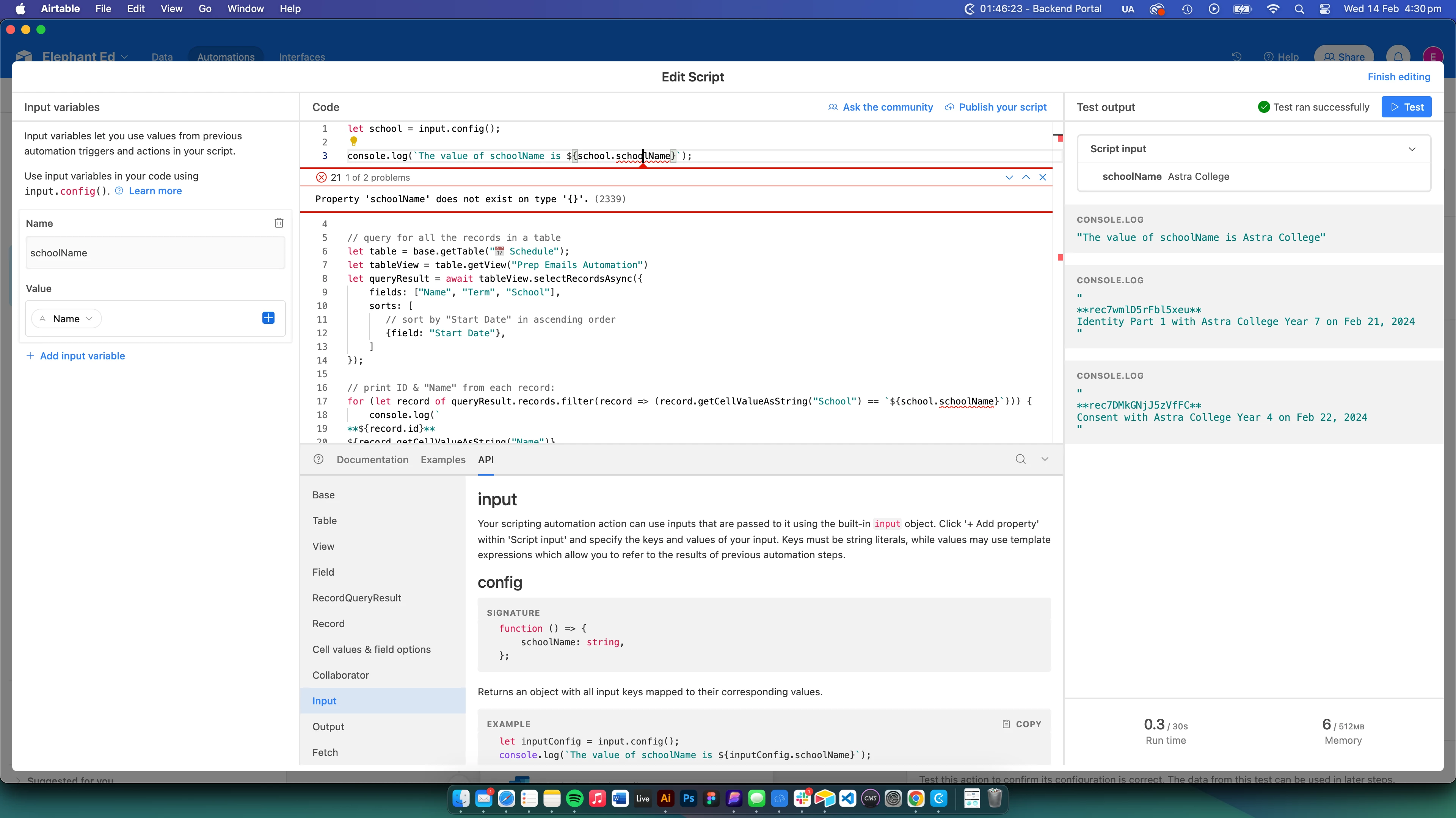

The script is below and it works but I keep get an error on schoolName (which you can see in my other attached screenshot) telling me:
Property 'schoolName' does not exist on type '{}'.(2339)
Can anyone help? I don't really know why I am getting this error?
 Thank you!

  • February 14, 2024
A closer look at the screen shot shows that the schooName input variable is being set. The output on the right panel shows that the value is Astra College. It's just the linter in the script editor that is getting confused.

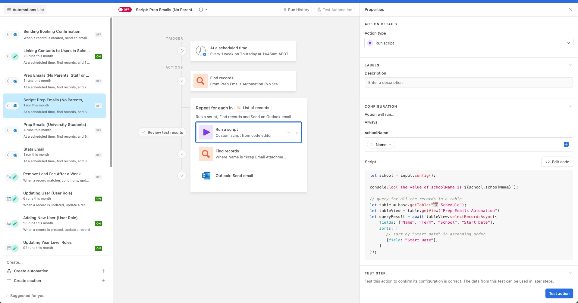

Ok now I can get it to work and output an array of the found records. Later in the automation I want it to send an email with those records, however, it only works for the first one that was used as test data in the script? the repeating group doesn't appear to be iterating through the list that was selected earlier in a find records
So the first email with 'Astra College' shows their records but then the next emails show blank records...
do I need to somehow clear the script so that it gets the next variable for input.config()? or something like that?
