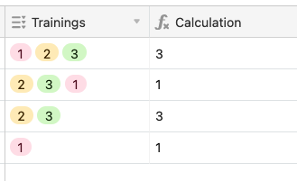

Try creating a formula field with this:
REGEX_EXTRACT( {Trainings}, '[^,]*$' )
This will output the latest multiselect option you've added to the field, and you can use this in your automation
