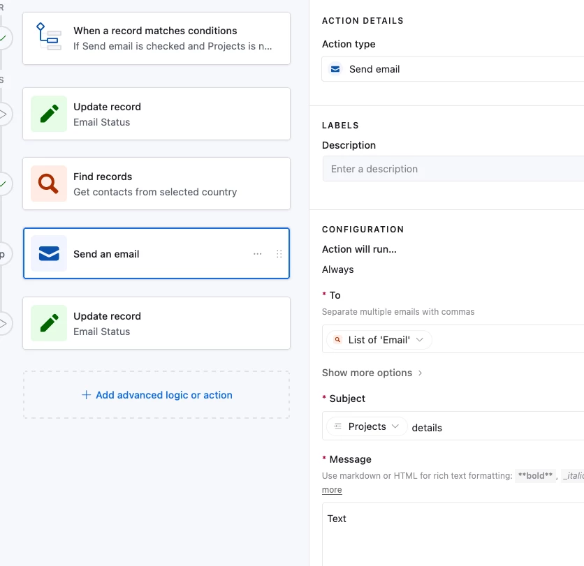

Yeah having a Campaigns table makes sense.  With reference to your example it’d be where you select the Project and Country for that campaign and I’ve set up something here for you to check out
Airtable comes with their native ‘Send Email’ action as well as the ability for you to send emails via a Gmail or Outlook account, so you could just handle it all on Airtable really (unless you’re planning on sending out like hundreds of emails a day or something)
Assuming your data looks something like this:

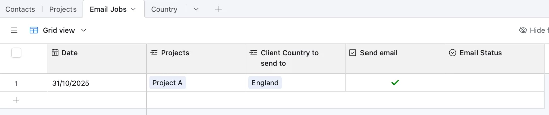

Then your Campaign table would look something like this:

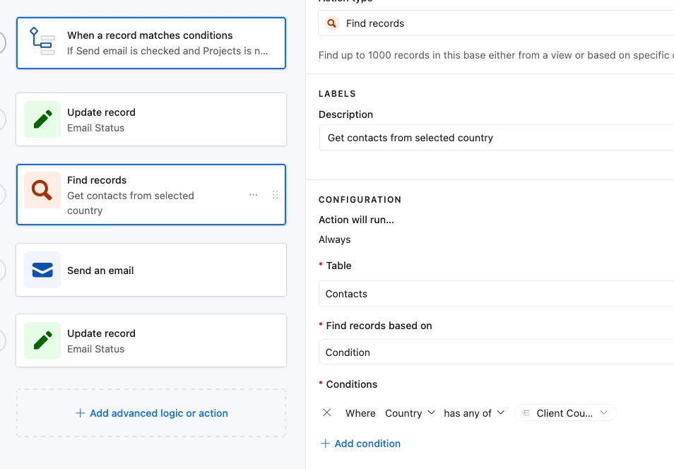

And your automation would look something like this where you’d have a ‘Find Record’ action to look for all the Contacts with that Country selected:
And you’d use the results of that Find Record action to compile all of those contact emails to use in a Send Email action
