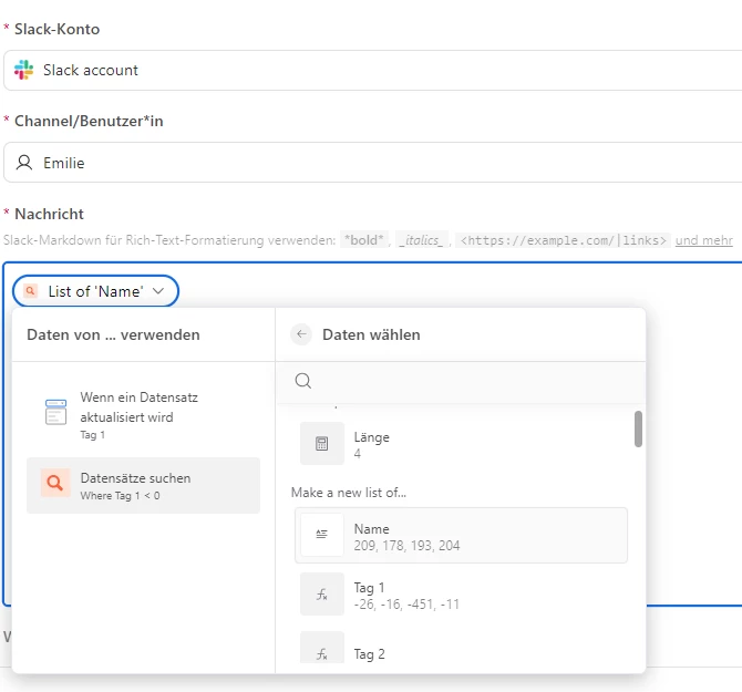

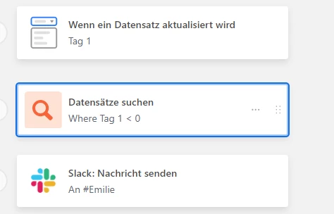

Hi Ella, I have tried everything in the configuration and either I get 1 message separately per Data which correspond to my Tag 1 < 0 which is sometimes up to 10 messages or I get all the number in one message but I get the same message 5 times. I also tried with emails and it is the same thing. Here is the screenshot of my current configuration but as I said I tried everything from all possible options.
  • October 20, 2023

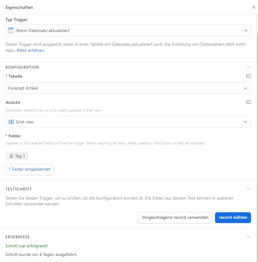

What is the configuration for the trigger?
  • October 23, 2023
Hi Ella, here is the configuration of the trigger
  • October 23, 2023
Since your trigger fires every time that the record is updated you will get a notification for each record that is updated.
If you want a notification for a group of updated records instead of one notification for each updated record, I would suggest having the trigger fire at a specified time (at the interval over which you need notifications) or when a button is clicked (if you don't mind manual input to generate notifications). Without changing the current trigger, I would not know how to solve your original issue.
