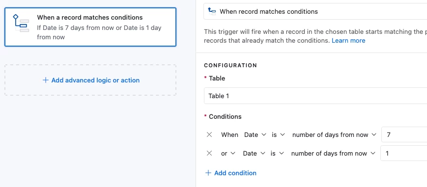

re: Over the last couple of years, I remember hearing on these forums that Airtable doesn’t update very regularly… and that if I say send it at 5:00pm Airtable might send it at 4:45pm or 5:15pm, or even a day late. Is that still the case, or can I send scheduled emails that are sent at the correct time yet?
That’s still the case I’m afraid.  You’d be using NOW() and comparing it against the appointment time to figure out when to send out the reminder, but NOW() isn’t that accurate.  From the docs as of 22 July 25:
This function updates when the formula is recalculated, when a base is loaded, or otherwise roughly every 15 minutes when a base is open. If the base is closed, it will update approximately every hour only when the base has time-dependent automation triggers or actions, or sync dependencies.
For what it's worth the 7 day and 1 day ones would be easy enough to set up, you could set up your automation trigger like so:
