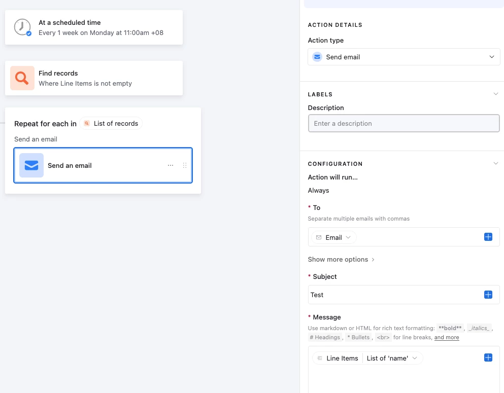

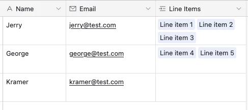

Apologies if it’s poor form to bump this but I’m looking for a solution that is almost identical so I’m hoping it’s more helpful to add to this rather than make a new thread.
I’m essentially in the same position however I currently have a single base, with multiple email contacts, the potential for multiple line items per contact, and I only want 1 x email per contact.
In the replies you’ve mentioned:
the simplest way to deal with this would be to have an automation per team
As far as I understand in my instance this would mean 1 x automation per contact which is not viable with roughly 250 contacts. Am I asking too much of my automations here or is there a way to try this?
Ah, yeah, I’d recommend trying the repeating group thing in this case.  Assuming you’re triggering the automation once a week, this is how a simple version might look, and I’ve set it up here for you to check out
  • May 9, 2025
Adam you’re an absolute wonder and I’m so grateful you took the time to do that!
Admittedly I’m a very low level of experience on the airtable scale so I had to wrap my head around it first but It worked a treat 😎 I learnt so much from your sample, thank you again
