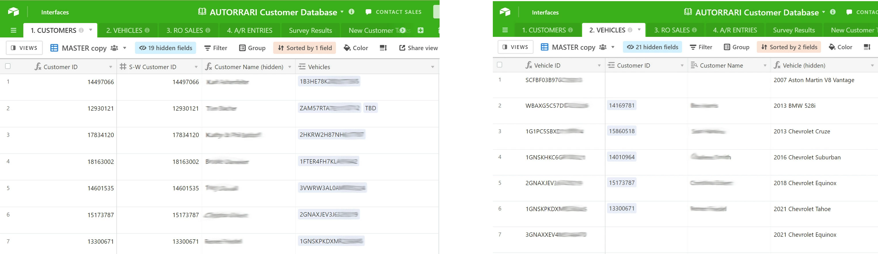

OK, you’ve seen this a thousand times… 2 tables, table1 is a list of customers & their CRM data. Table2 is a list of Vehicles. One customer can have many vehicles, but one vehicle can have only one customer.
Both the ‘customer’ and the ‘vehicle’ data is being dumped by zapier into their prospective tables. AND lest I forget to add that BOTH tables can/are bringing in the unique ‘customer’ ID. Also, the ‘vehicles’ table will NEVER populate before the ‘customer’ table does.
I’m trying to EITHER add the ‘customer name’ from table1 to table2 OR add the ‘vehicle name’ to table1. And I was thinking about using an automation.

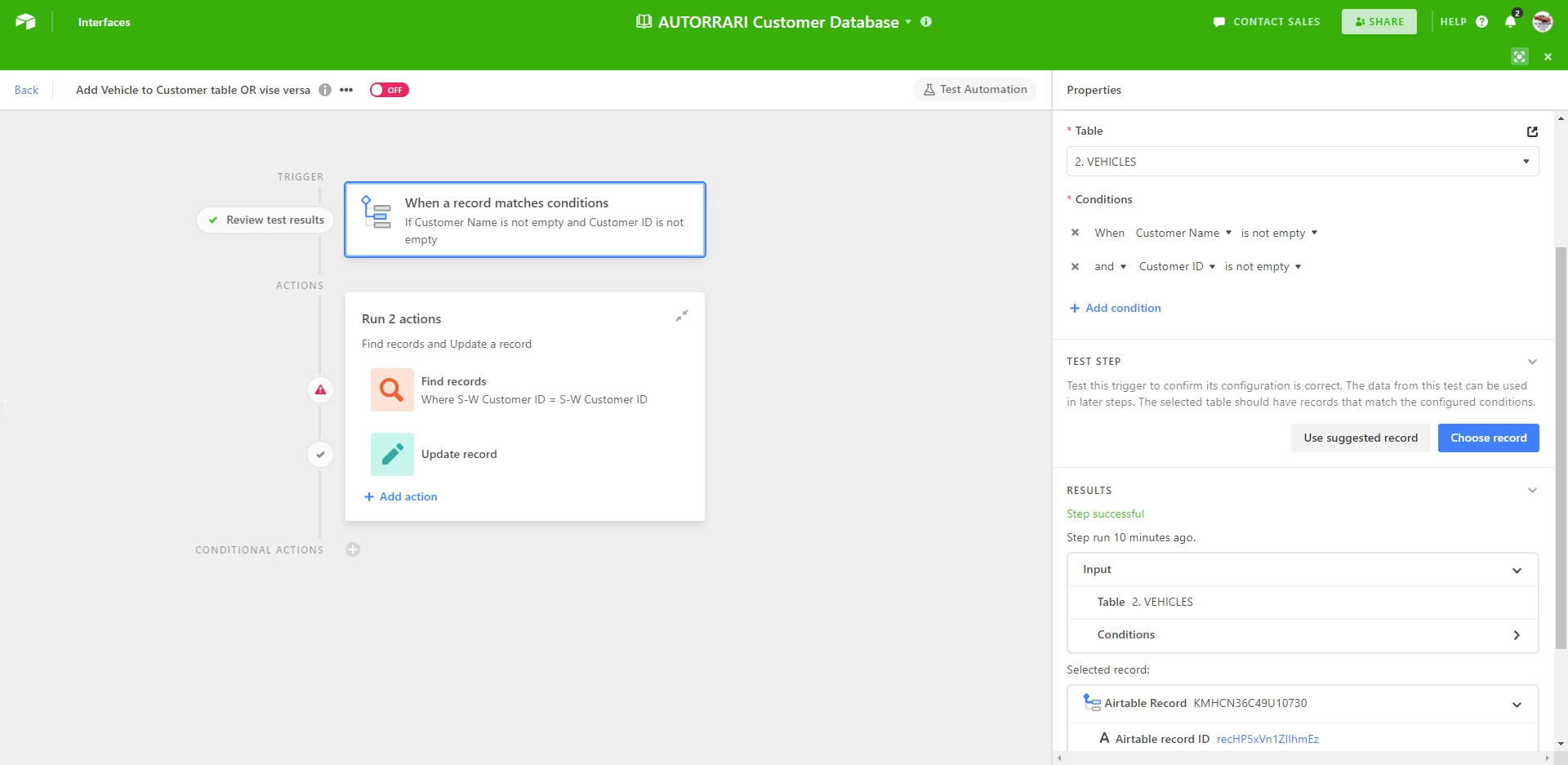

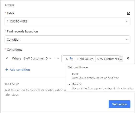

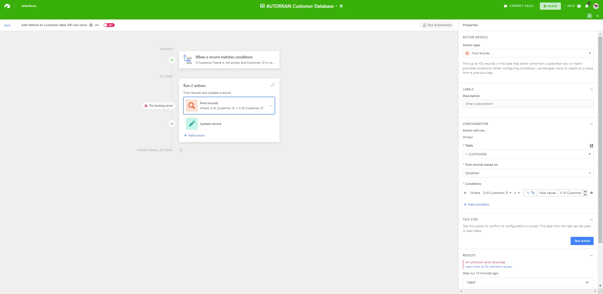

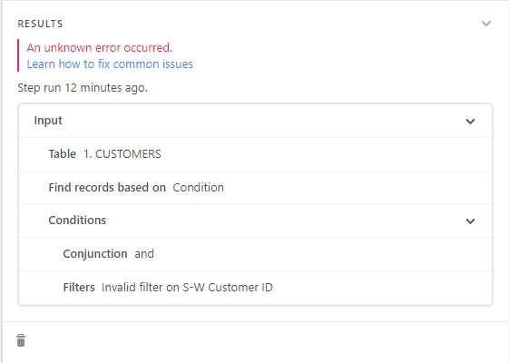

OK, so the ‘trigger’ worked.
But when when I get to the ‘action’ it falls apart:
What am I doing wrong? I KNOW that we are close…
II used ‘dynamic’ for the condition. Is that wrong???
Thanks,
DG
  • May 12, 2022
Thanks,
DG
It is hard to tell what is going wrong. Here are some standard troubleshooting ideas
  • check the field types of the fields involved. I was assuming that they were single line text.
  • try retesting the trigger and picking a record that you know has values that make sense
  • when all else fails, sometimes rebuilding the automation from scratch helps

Hahh! Hahh! Hahh! I got it! Turns out I missed one of your suggestions… Thank you… again!!! :grinning_face_with_smiling_eyes:

zooomed right past it and had them in backwards! :motorcycle: :checkered_flag:
