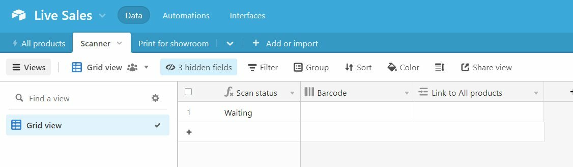

In an attempt to make a "scan inventory" system in Airtable, I have been playing around with the following automation:
I have a base with all our products listed in "All products" and another linked table "Scanner" that links back to "All products"
The primary field "Scanned" is setup with this formula:
IF(Barcode, "OK", "Waiting")
So if the "Barcode" column is empty we show "Waiting", and if not we show "OK"

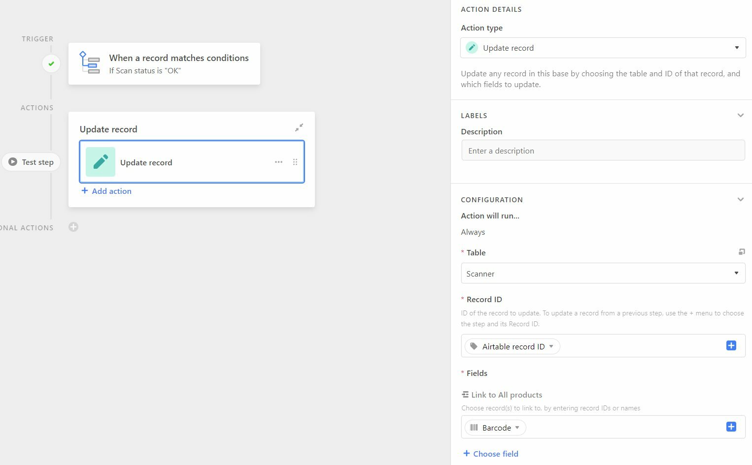

I then have the following automation setup:
So basically, whenever "Scan status" changes from "Waiting" to "OK", we want to update that record by inserting the "Barcode" value into the linked column "Link to All products".

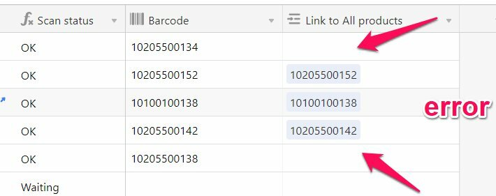

This works everytime I test it inside the Automations tab, but when I try testing it by scanning some real life barcodes, it only works for some records:
I have of course verified that all the records actually do exist in the "All products" table.

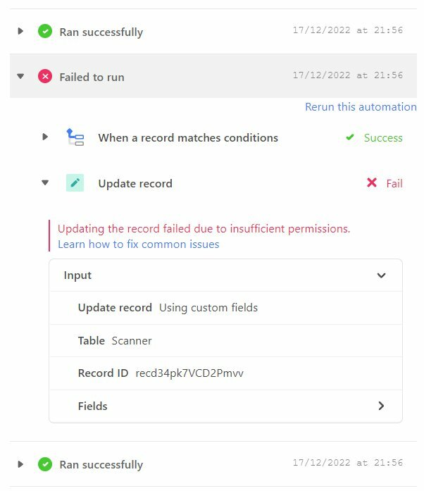

The error I am getting in the automation history tab is:
And so my question is basically, why does it sometimes work and sometimes not? What do I need to change regarding my permissions to make it work for all records?

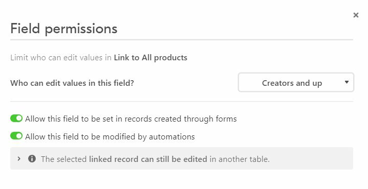

All columns in both tables are set to the following:

I believe that the permissions issue is due to the fact that you are linking to a synced table. Because the table is a synced table, the automation cannot create a new record with the given primary field. This supports Adam's idea that there might be some hidden characters for the affected barcodes in one of the two tables.
