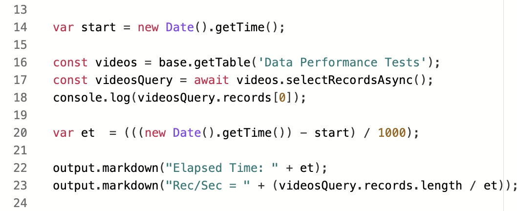

Some deeper details—you say the records are already loaded, but why is this so slow?
    const videos = base.getTable('Videos');
    const videosQuery = await videos.selectRecordsAsync();
    console.log(videosQuery.records[0]);

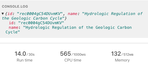

Bill_French
  • December 18, 2020
I do not know, but when I run your example on a 22,538 record set, is shows it processing about 8000 records/second.

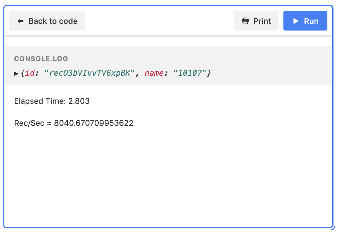

This code …
I just discovered that my script works fine when I use it in a standalone scripting app in a dashboard. What is giving me problems is when it is run as an automation.
