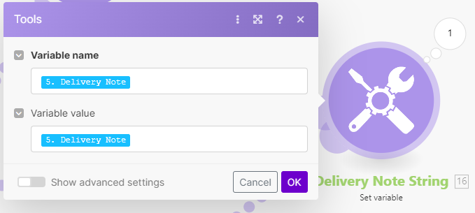

Make.com
I have tried to do this through Make, but I am getting some strange results with it picking it up the single select, able to convert it to a string and even output it on an email, but this only works for the value that was selected during the construction of the make. As soon as it in changed it doesn't work (no errors, just doesn't show up in the dynamic field).
This has stumped me! Any advice would be great

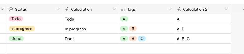

May I know what issues you faced with creating a formula field with the field name and then using that formula field's output in Make?
  • September 20, 2024
Seems I was completely over complicating my side of things, that works great, so thank you for that! Is there anyway to keep it keep it in Airtable, so if someone in an interface chose a single select they would see it appear in an editable text box,
