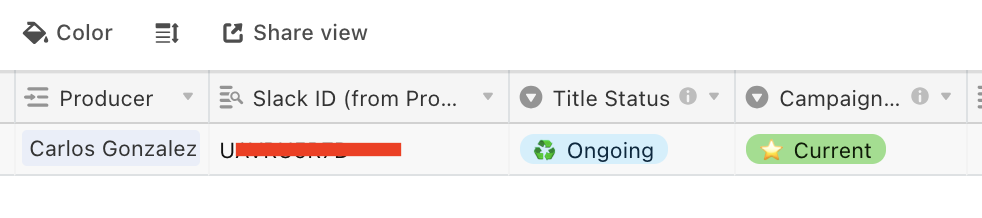

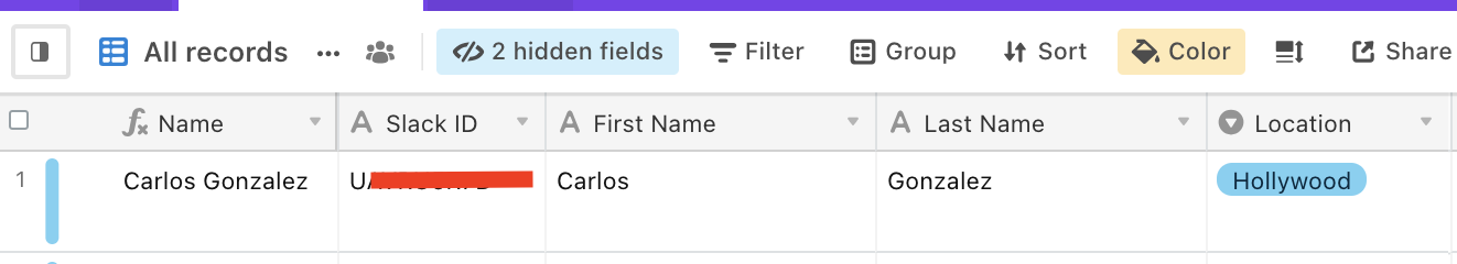

Do you have a Table that contains all of the people that the project can possibly be assigned to? If you do, you can create a field for the individual’s slack ID.
Then in the table where you assign things to people, you can create a field that links to the table with people and their Slack IDs. Then in that same table, create a lookup field that looks up the individual’s Slack ID.

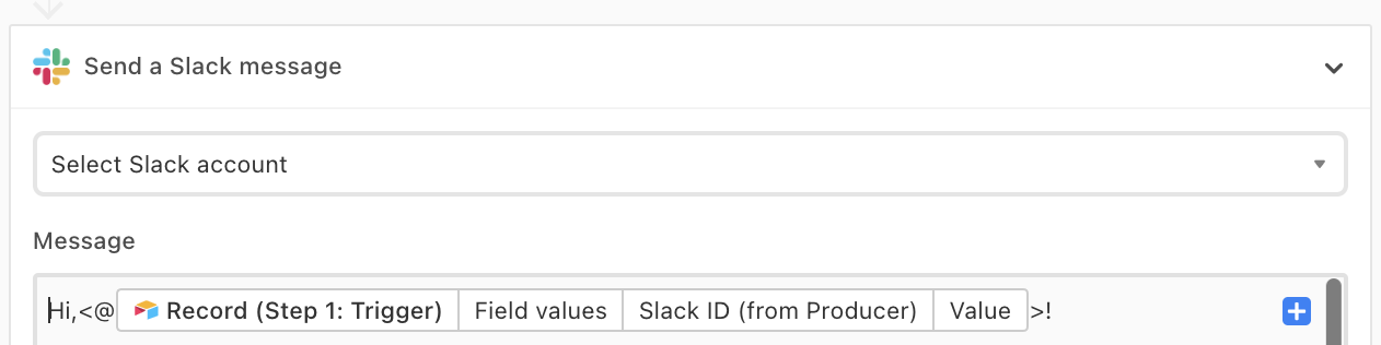

Then you can format your automation in the automation sidebar like this:

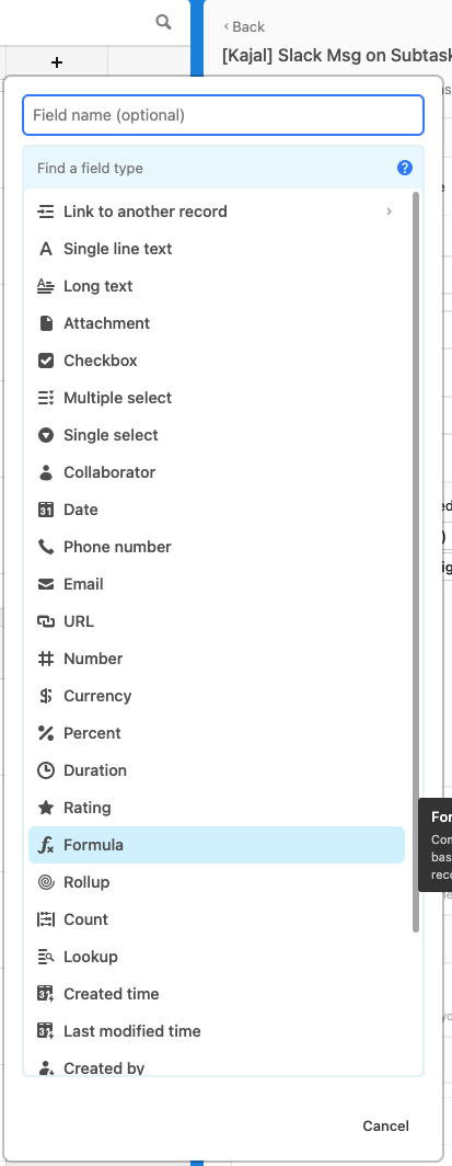

Gotcha. Well, in that case you could just do a Formula field. Something like this:
SWITCH(
 {Producer},
   "Carlos Gonzalez", "@SLACKID1",
   "Ashley Posluns","@SLACKID2",
     "none"
So the {Producer} field is the field that you use to assign people. The only problem with this is that you will manually have to add a new line to the formula above when you add a new person to your list of folks who can possibly be assigned

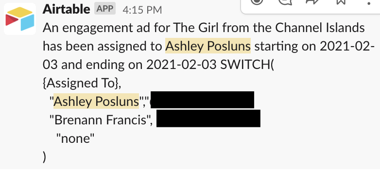

Thanks Carlos! Do I add the formula field into the automation “action” part? Or I’m adding this into a field in the table? Sorry, confused!
I tried the former but this is what I got on slack
  • August 6, 2021
I think he meant you should create a “Formula” field in your table and put the SWITCH statement there
Then reference this field in the automation “action”
