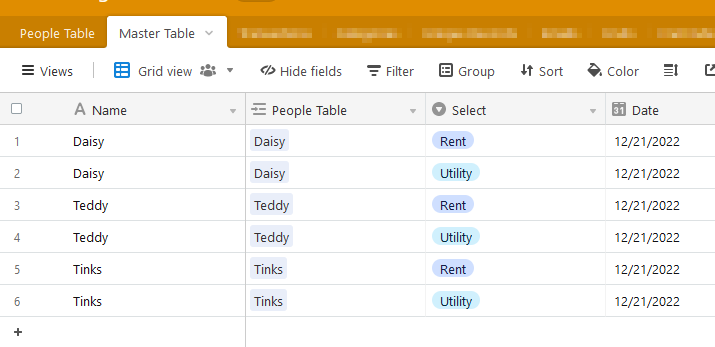

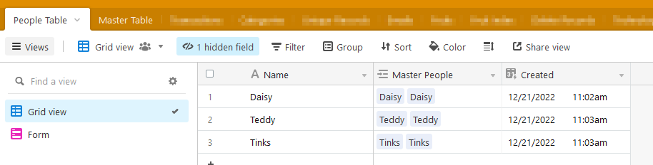

You could definitely no-code a solution for this - such as with two tables;
First table with a Form View - and form entry is critical for no-code automation to trigger record creation, where the name of the trigger record is being copied into subsequent fields. A form allows the complete capture of the name upon form submission - where other trigger methods often result in empty data being used upon triggering an automation.
Second Table where the automated records are created.

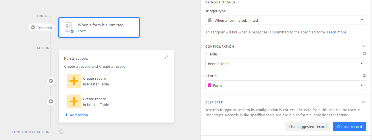

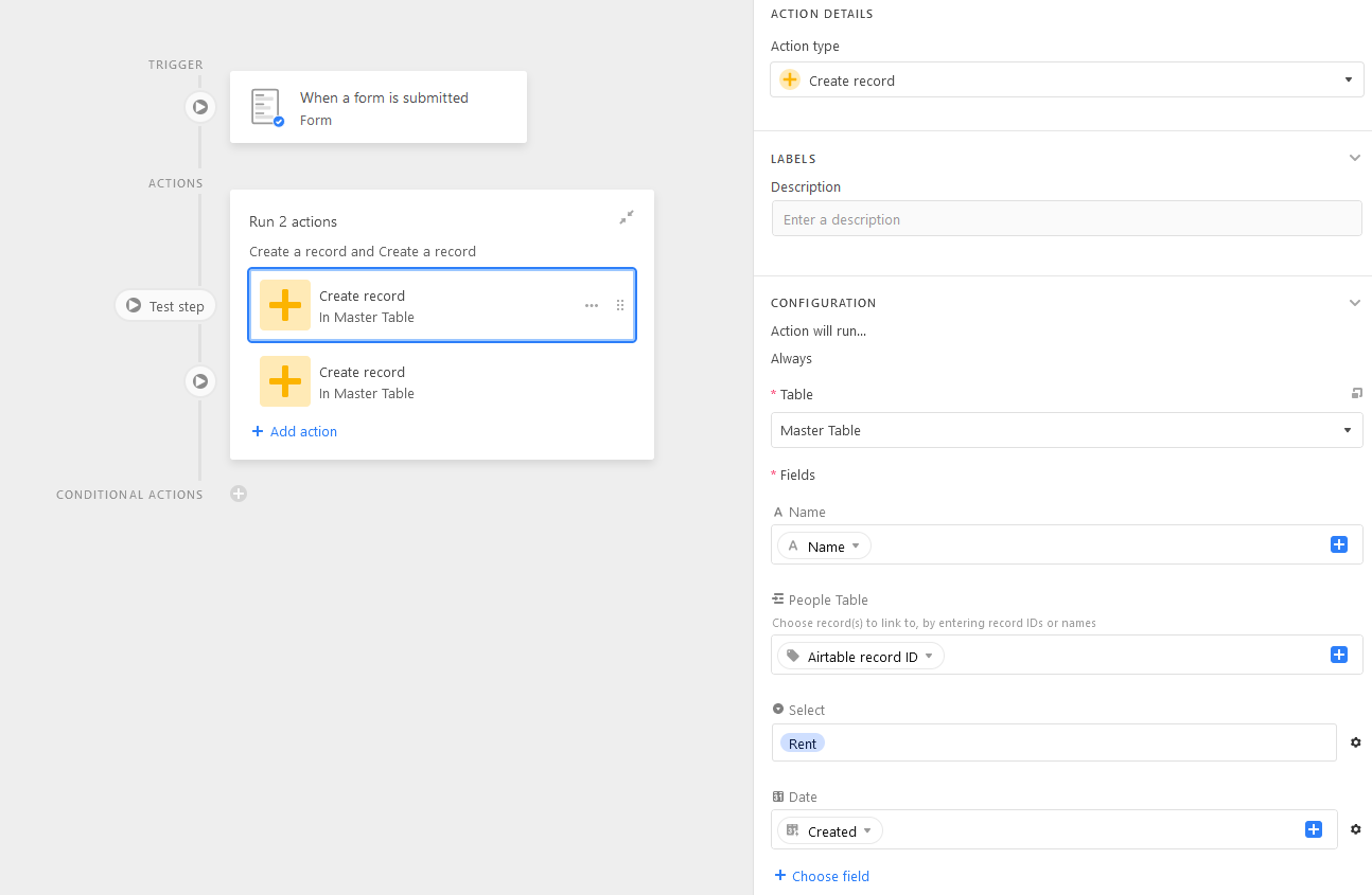

Automation could look something like this - note that the trigger is upon when a form is submitted;
