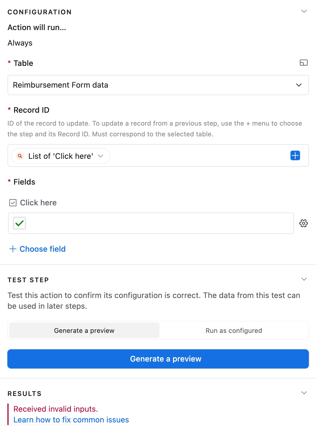

HERE’S THE ISSUE - I can’t figure out how to create the automation to update the record.

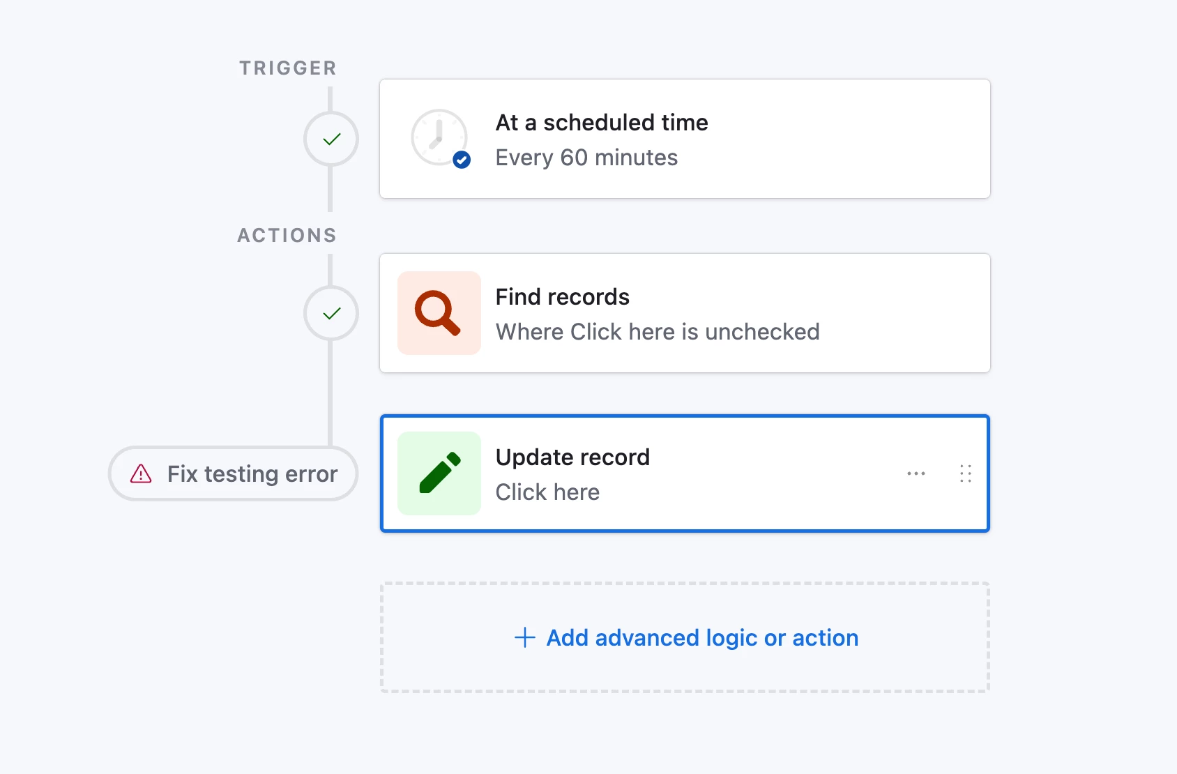

  • I have a field with a check-box - I have created an automation that once that check-box is checked, it runs the consolidation - that works really well.
  • What I want to do is to create an automation that will automatically check that box if it’s unchecked at a certain time interval.
    • sounds easy, but, I keep getting an error that says “Received invalid inputs.”
Here’s some screen shots (please let me know if you need to see anything else):
Thank you so much in advance - it’s driving me crazy!

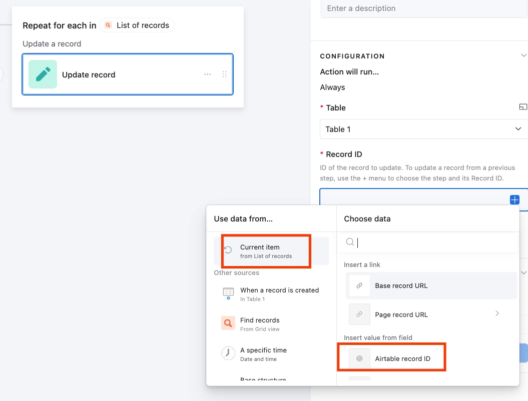

Ah, try adding a Repeating Group to your automation and use the ‘Find record’ results as the ‘Repeat for each’ value, then use ‘Current Item’ and ‘Airtable record ID’
Here’s an example base in case that’s helpful, and here’s a link to the docs: https://support.airtable.com/docs/repeating-groups-of-automation-actions
