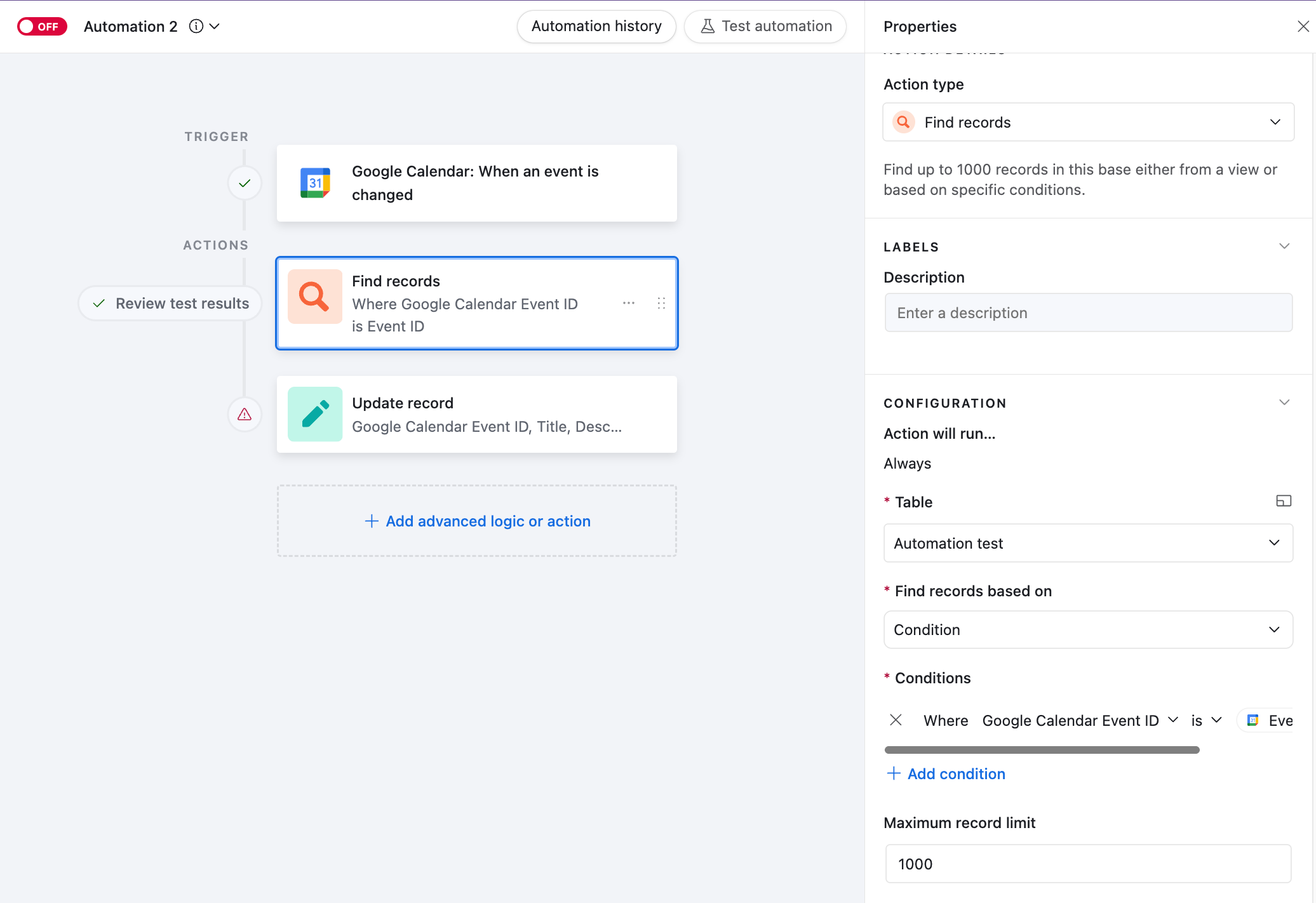

I believe I have the Find records action set up OK, see screenshot below (although when I test the step at that stage, it says Found 0 Records but I guess this is because the table is empty currently...)
My screenshot: Find records menu

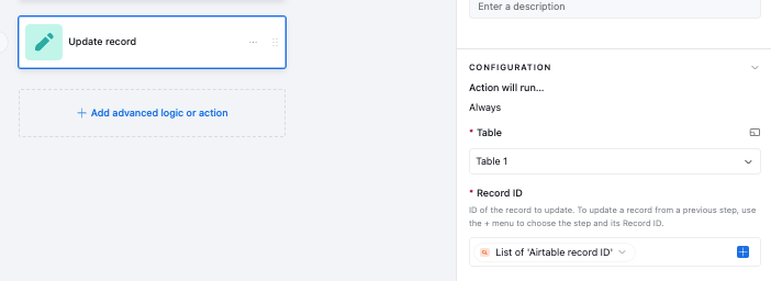

Where I’m really getting lost is with the Update record part. According to AirTable Support, “the ID of the action that gets the information to be used goes in Record ID, and should look like the below. “This is because this Integrated Trigger is not directly related to an airtable base or table, instead, it is related to the calendar account. Once the Record ID is set, the system will be able to find the record realted to the automation update record action”
AirTable support’s screenshot

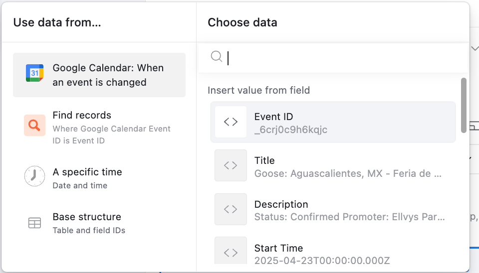

However, when I click the blue + beside Record ID, I get the below menu, and can’t see any List of “Airtable record ID token option. The closest option I can see is if I select Find records and then select List. However, that just takes me to a Select fields to show menu, with no List of ‘Airtable record ID’ as far as I can see.

You get the Airtable Record ID from the result of the “Find Records” action.
You may also need to set up conditional actions based on whether or not you actually find any records. If you don’t find any records, use a Create Record action to create the record and store the Event ID for future use. If you find one record, use an Update Record action with a new list of the record IDs from the Find Records action. If you find more than one record, you have a problem.
