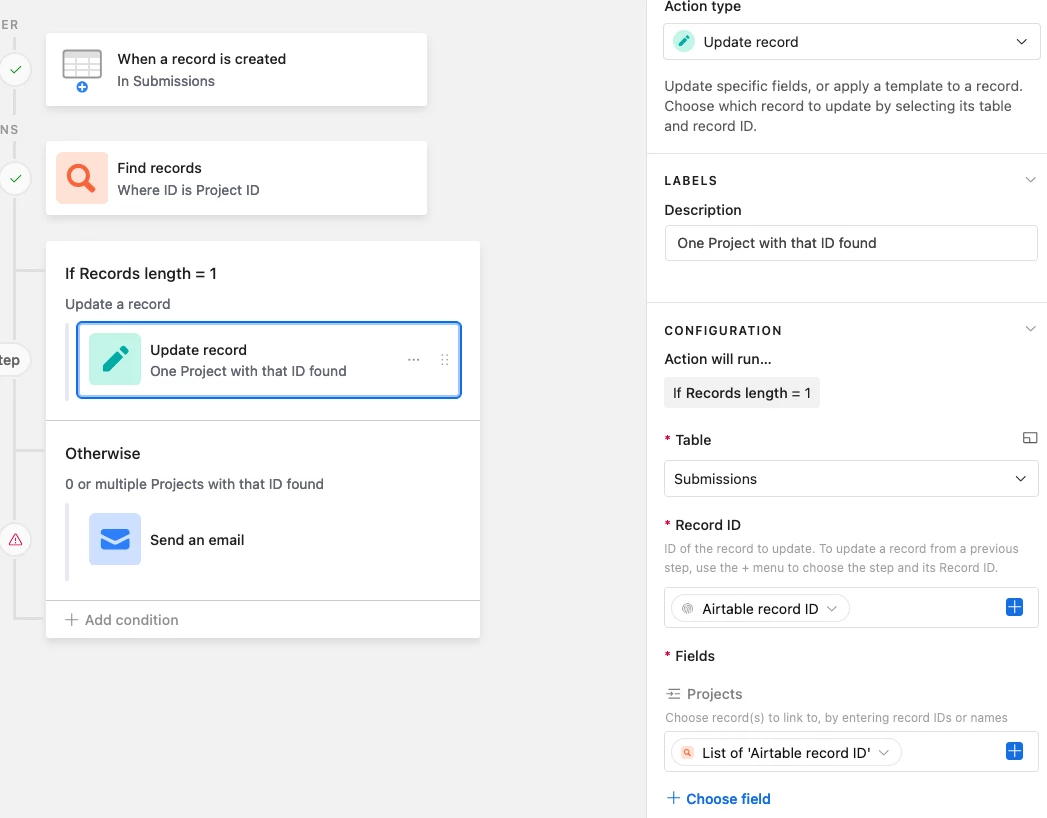

Hmm, try creating an automation that triggers when the form's submitted and looks for a Project with that ID.  If it finds one, link it to the new form submission.  If it finds more than one or zero, get it to email you to tell you someone typoed their project ID
