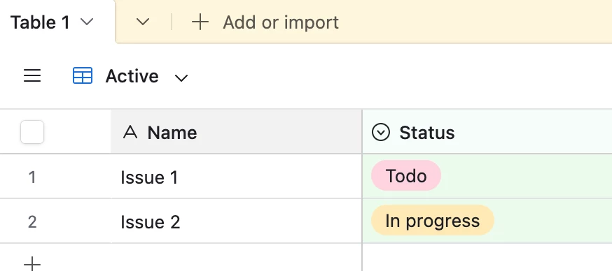

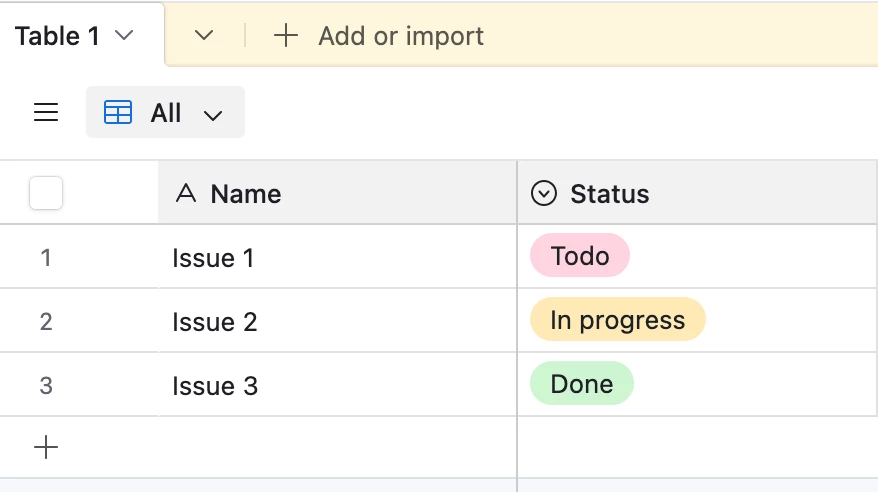

I’m curious what you’re trying to do though.  Generally if the data between tables is 1:1 the advice is to just keep it all in one table and use select fields and views to handle it instead of using a new table.  (I bring this up as you’re asking about keeping things synced, which seems to hint at the records in each table being 1:1)
For example, in the screenshots below, we have an ‘Active’ view which shows all records with Statuses that are not ‘Done’, and an ‘All’ view that just shows us all the records instead.  Apologies if I’m way off the mark here!
